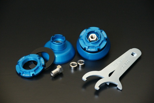

People have only told me that it "can't" be done.... And since I've now gone through 2 sets of strut bearings -___- AND Camber bolts are not allowing me to get the camber I need now on the shorter bodied Skunk2 coils... AND the top OE rubber top hats can, well, get less reliable at sustained cornering G's and begin to have "self adjusting caster." Mega no bueno. Only thing out there now is the Cusco "center lock style." Special order only and $300+ Name:  3866SR01S.jpg

Also a way to incorporate a needle thrust bearing so that pre load is easily adjustable and to cut down on binding...

Not sure... I think it has something to do with the way the upper strut mounts.
I included the pic of the Cusco mounts above for what ever reference they can be...
Ideally it would involve NO CUTTING or major modification to the upper strut tower (SCCA Class rules) and allow for adjustment of up to no less than -3.0... Ideally

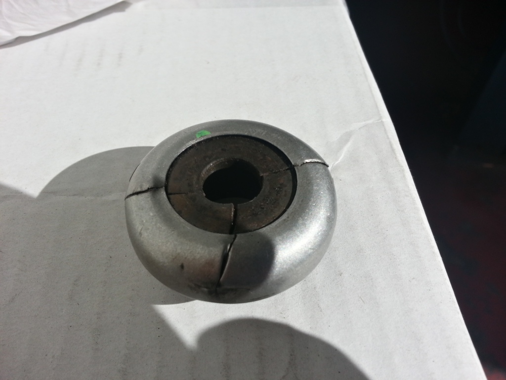

Originally Posted by Wafulz
Off topic how u knw when your strut bearings are bad
"new" noises And I have been constantly pulling apart my front end to pess with shock length, pre load, and springs so I found out when I took it apart and saw this:
May have been over tightened... but cracked nearly in half. The bearing grease was running down the piston of the damper and I thought I was SOL and they were blown

so sperical bearings are in order..
were you talking about a trust bearing between the bushing and nut? im slightly confused by that one.

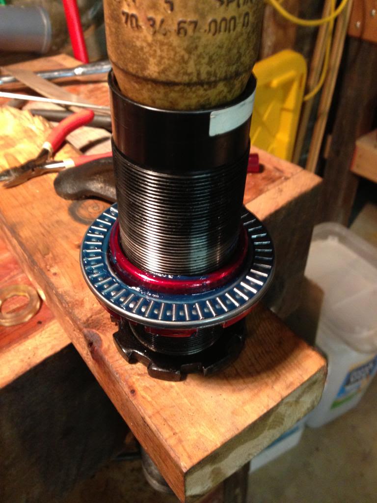

Mostly been watching this guy's work and seeing what he did: https://www.fitfreak.net/forums/fit-...ml#post1179424
Not sure if it would be specific per the coil over or not:
Old May 8, 2013 | 02:30 PM
seeyalaterbye's Avatar
Joined: Jul 2012
Posts: 92
From: Seattle, WA
ive seen that thread. im pretty sure he found a thrust bearing that would fit and just added it. i know alot of higher end coilover kits have those already. as for doing a camber plate kit, it wouldnt be hard to integrate into the plate. but like i said, its only a mental image at the moment.
