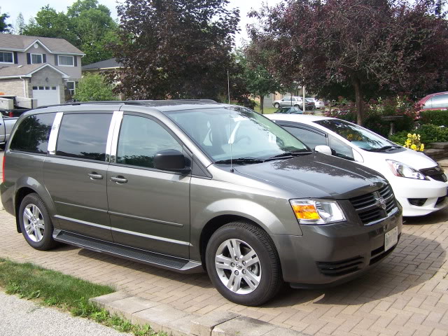

If its any consolation you could be driving a Dodge minivan.
Hey, I resent that. lolName:  007.jpg
