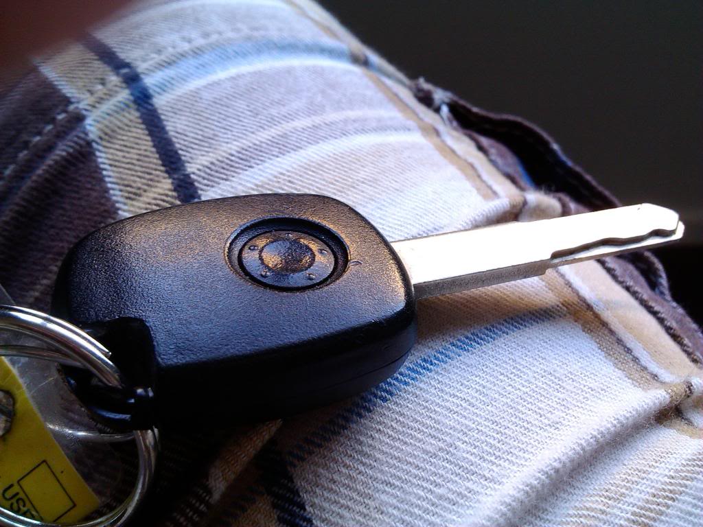

I received two keys with the car and one has a central button. Does this mean I have remote locking or an alarm?
I replaced the battery in it but when I press it, nothing happens. Is there a way for me to check to see if I do have an alarm or remote locking feature?

Never saw a key like that, can't help you there.

That key doesn't even looking like an OEM Honda key. Unless Honda has different key designs for different markets, the key you have is an aftermarket unit that was simply cut and programmed to for your vehicle. You can try programming the "fob" to the car to check if you have keyless entry. Simply cycle the key from the "OFF" to "ON" (not running) position, press the "LOCK" on the fob, then cycle back to "OFF". Repeat this 2 more times... Once you've cycled to the "ON" position for the third time you should audibly hear the lock actuators cycle once you press the fob button. Note: If you have multiple keys, press the "LOCK" button on all of them while the key is still in the "ON" position or they're keyless entry function could be lost.
If you hear them cycle, programming is complete and you have keyless entry. If you do not then you either have a key which cannot be recognized by the keyless entry, haven't done the keyless learn sequence properly, or just do not have keyless entry (call/go to Honda's parts department with VIN number in hand to confirm).

As above, I cannot comment on the key, but the green temperature light is simply indicating that the car is not fully warmed up yet. Note: Until the green temperature light goes off, the engine will not go into VTEC. Perhaps that is the jerking you are experiencing, i.e., the ECU is limiting your RPMs until the engine is warm.
I'm with the others about the key, that is one of them the aliens dropped here to test us with I rekon.

I tried the key cycling trick that you suggested Hootie, but didnt hear the actuators working after the 3rd go.
Tried it a few times and nothing happened.
I am going to get a car stereo fitted in a couple of days time, so might see if the electrician can confirm that I definitely don't have remote locking.
