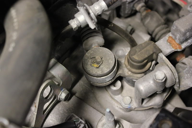

There's a shift linkage from the shifter to the trans.
This guy:
What synchromesh did you use? I was reading the GM Synchromesh Friction Modified version is the bees knees but also that it's not readily available anymore. Is that true or do you just use the standard Synchromesh fluid?
This guy:
I used what ever they sold me at GM. It is written on several boards to use GM. If it's just synchromesh or the friction modified. Regardless of which you use you will not be disappointed. I've always known about this. I've used it in my first car an 89 EF Hatch back when I was 16.
Also thank you for that picture. I'm going to grease the hell out of that circle tonight or tomorrow. As for under neath my shift boot I'll wait till spring when I actually have to fix my shift boot haha. Need to do a touch up of my leather JDM boot install on the bezel.
