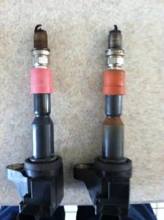

Hi, I went to put in new rotors, Pads and plugs in the last 2 days. My Fit has 90000 miles on it.
1) Those screws holding the rotors in were horrible. A huge battle to get them out. Had to Bang them then turn , bang turn. terrible.
2) The second plug was very tight. I was worried I would break it. So I shot some wf-40 down there. and went back and forth until I got it out. The plug had some burn signs.
3) The coil looks burnt and discolored.
Any one know why this happens.
I saw a replacement coil on eBay for $16. Do you really think it matter that i get OEM?

Its hard to tell from the pic but it looks like the plug in that coil has marks near where the porcelain meets the metal. Spark plugs can slowly fail and leak combustion gasses through that spot which can be similar in color to what you see on the coil. That hot exhaust leaking could lead to a coil failure over time if it heats the coil too much. It could be that or the coil itself just starting to burn out.

I had this VK20 from old GD FIT installed on the GE... once i realized that those were not recommended, i decided to switch back to the OEM sparks. The Pic is what i found. 2 coils were decolored. Also the Spark threads were quite oxydated I would said being very thight. Iused Oil a little bit to soften them, whic was not a good ting to do.. lol
After lots of reading, he heat dispersion ofthe Spark plug if it is not good, or if the spark is loose may cause damage to the coils.
Some people in the threads use IK22 which if i am nt wrong are colder Sparks ( means that can dissipate the heat better, therefore wont over heat the coils....) I ended up buying 2 coils to replace the discolored ones and IK20L which are the sparks recommended in Asia...
I did use dielectric grease from a Tunning Kit from Loctite,which protects the threads of the sparks, and softest the contact between the plug and the coils... also prevents some electric arc or something like that...
The Engine recovered power.
