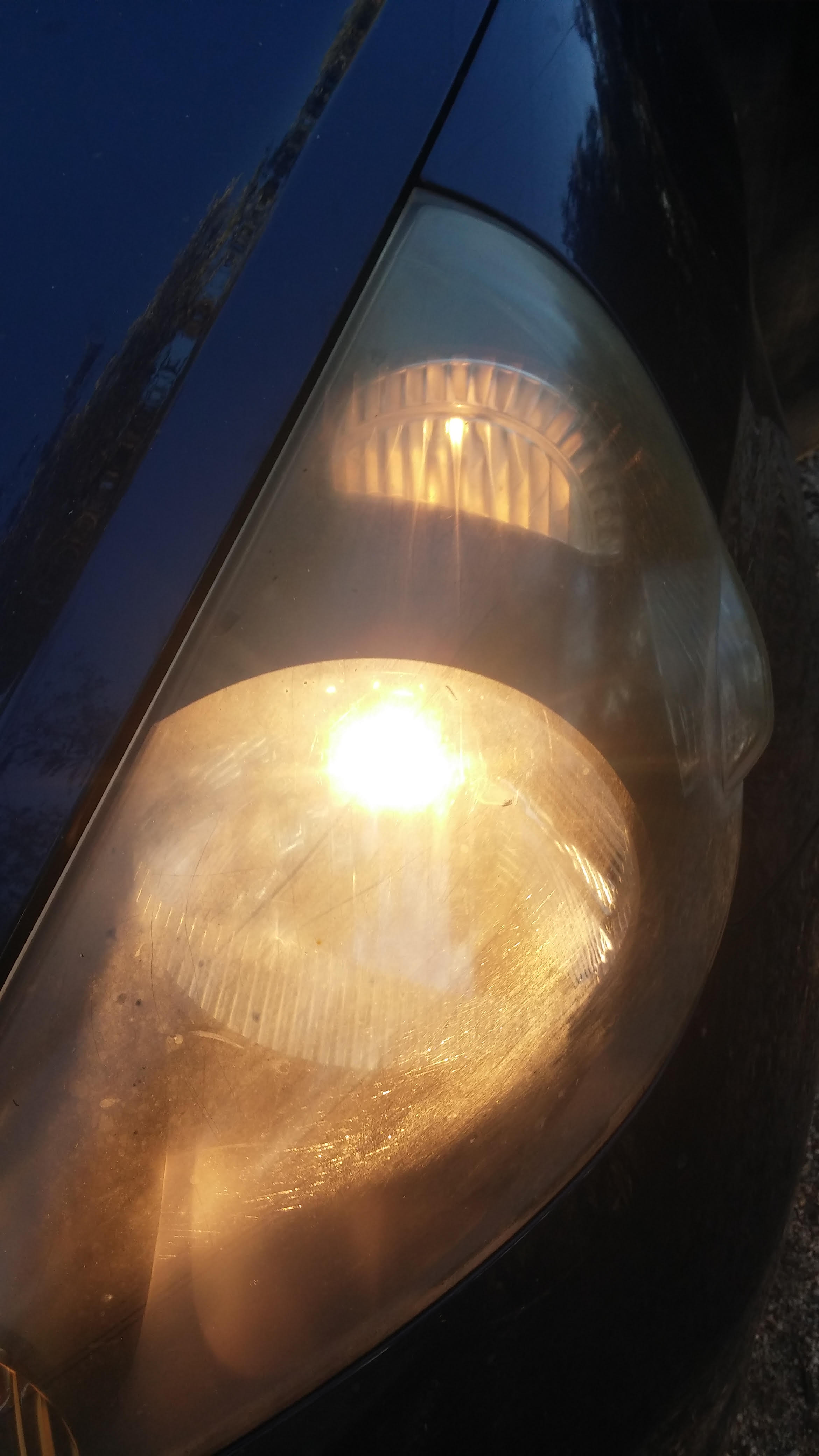

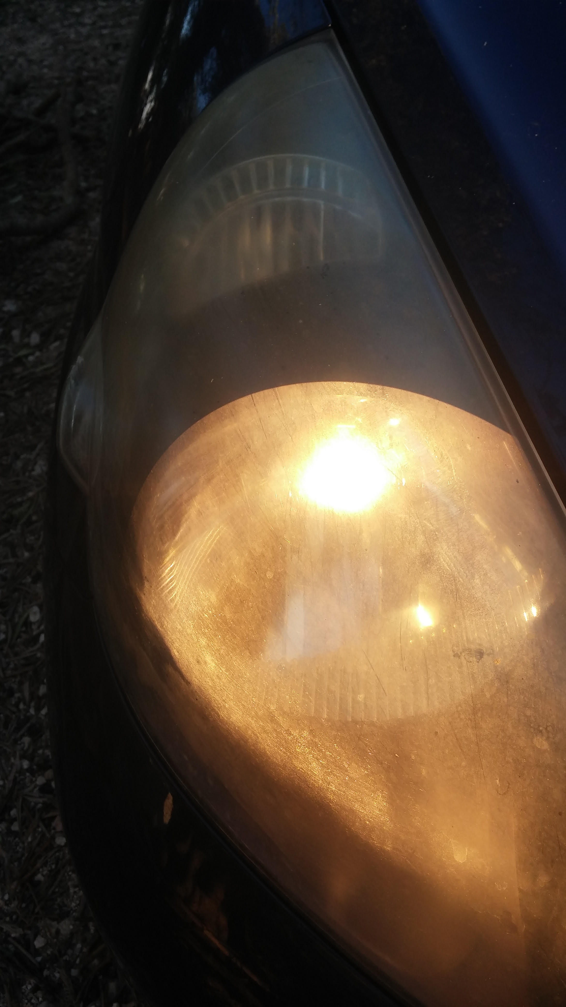

Hi there!
I just discovered that the head-lamp case's small bulb, is not lit. Seems it is burned..
Anyone knows the name of this type of bulb?
I would like to replace the pair (both lit and burned ones) over a pair of blue or blueish ones..
I attach photos to help clarify the name/type of the lamps..
Kind regards, Kostas
(the car is 01/2003 European Honda Jazz/Fit)

I believe that's bulb # 2827

Also could be called a 194 or T10. Commonly referred to as a peanut bulb as well.

mine does that I pulled it out and connected it to the battery cause it didn't look burnt and it worked turned out it just doesn't sit in properly about 2 months later it happened again I've yet to check it again.
Most the time if a bulb is gone I don't bother asking on a thread i go to my local auto parts store and say "I need a new one of these"
part numbers are meaningless over here in Australia haha.

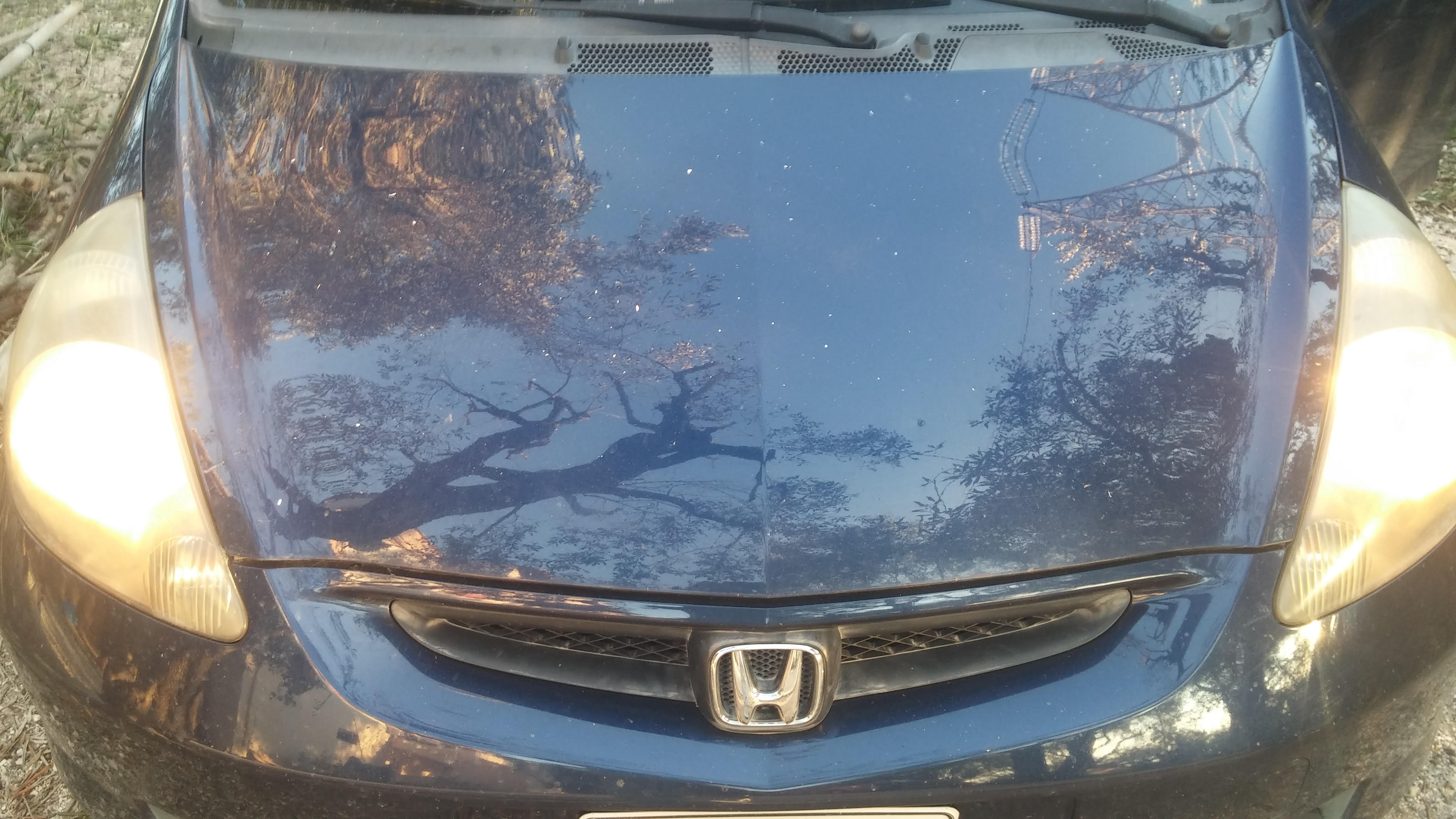

seems like your headlamps needs a little polish too.
