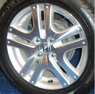

These are 16's what size tire would I need? Should I look for a wheel with a offset closer to +38. I don't really understand the offset too much. I want good looks so I figured going to 16" would be safe. But with the different offsets It's gets a little confusing. I also going to get a good 50-75k warranty tires. Just need a good safe size to shoot for:
Here is a 15" Wheel closer to stock wondering if I would just want to shoot with the same tire size as stock for wheels like these:
Thanks for the help guys!!!!

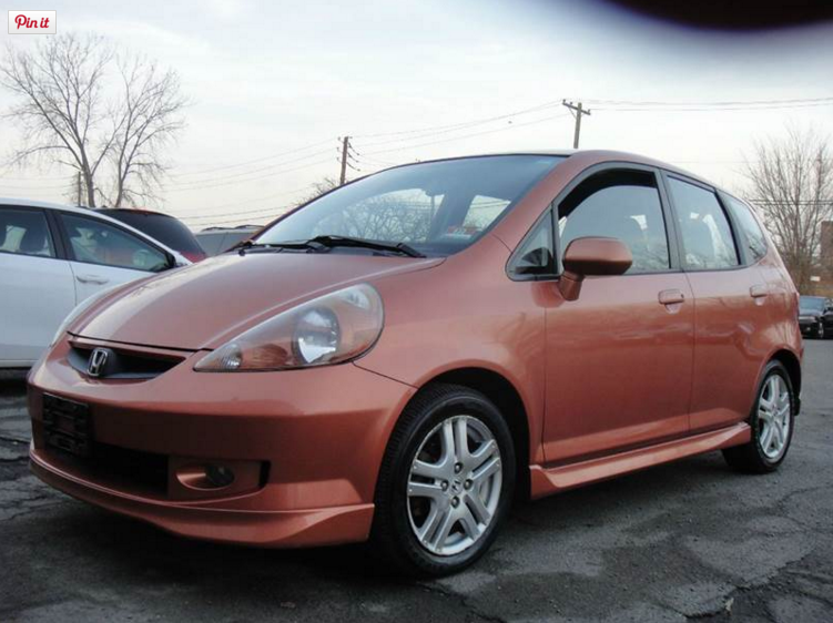

My wheels look like this(better than hubcaps) but still not worth the risk:
Ive read a lot about these type's of stock wheels getting stole:

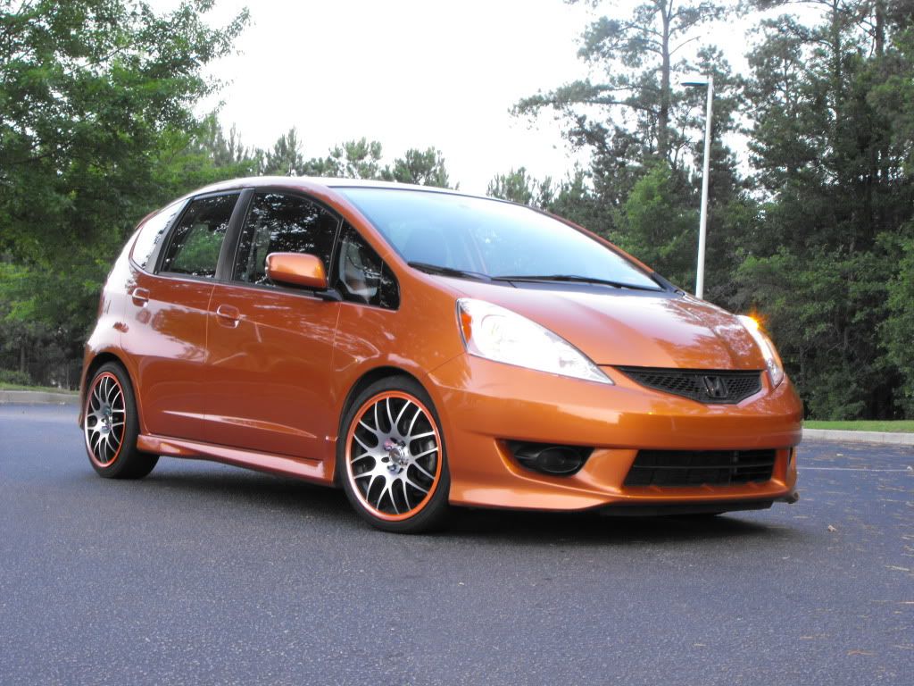

This is what I have:
This look is what I want:

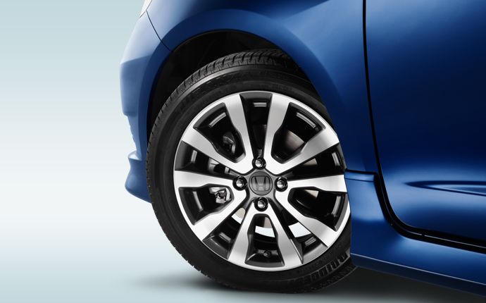

I was thinking about going this combo route. But man those Enkei's are spendy with center caps and the works. Maybe I'll shop around, I have about 1,100 for the project.

This looks good with lots of clearance:
