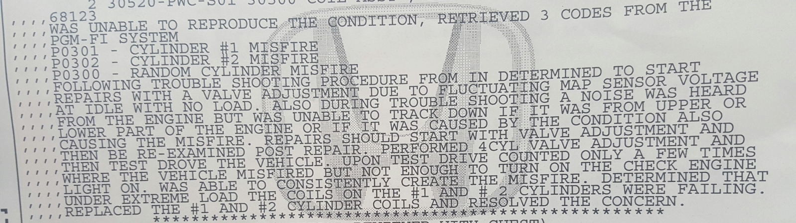

the tech warned me that my other 2 coils were going to go out soon. he said that valve adjustment was a little unusual (prob from city driving) but the coils being replaced is standard maintenance.
here is the report...does this sound normal?

Holly, if you are worried about being told that you need work that is, in fact, unnecessary and being ripped off — I know I always am — you shouldn't be. A valve adjustment at your mileage is a good idea (the Owner's Manual notwithstanding), and, from what my colleagues here on the forum say, it may be quite reasonable to replace the coil packs.
2 coil packs versus 4 coil packs? I would change them all at the same time just to be thorough, and I wouldn't be bothered by the cost, but others here will disagree.

Rock auto sells the coils for just under 200 for 4. Honestly its too easy to pay the dealer to do it.. 1 beer job tops..
But I like that the tech did actually note down that the valve adjust helped and the coil packs topped it off.
