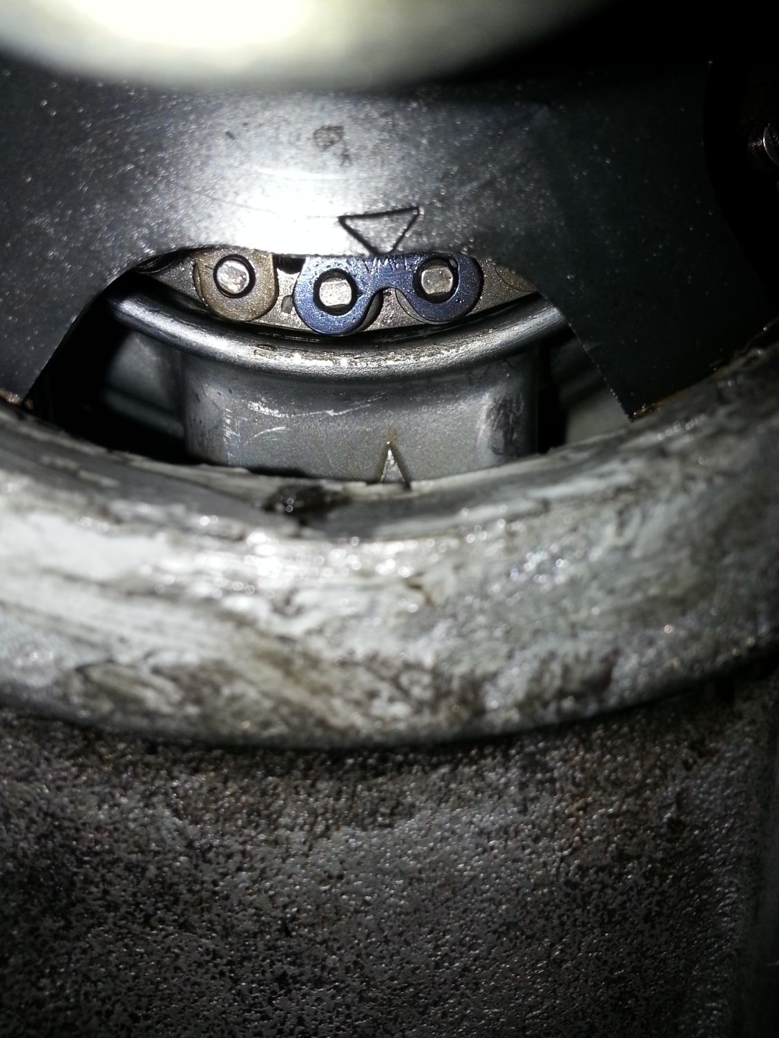

Very important:before removal of timing chain, mark the chain to cam and crank sprockets!! Then align the marks during re-assembly and watch them during installation of the chain guides!This will eliminate chain slack and prevent timing to be off after re-assembly

^^ - Listen to him. I actually messed up the timing when working on my car and the car wouldn't start. Had to re-do the whole thing which was a huge waste of time.
Here's pictures I took for reference after I finally got it right. There are different color links and arrows to help you align them. Make sure you get your TDC.
Cam
Crank
Attached Thumbnails Blown out spark plug? Cylinder head remove/install??-80-20131206_192129_78844c9b953853527a12947107a36ad242cf4294.jpg   Blown out spark plug? Cylinder head remove/install??-80-20131206_190924_0d42c95449d1c1bb302989318c64bf3f55d18e28.jpg

This issue ("slack on the tension side") is quite common when doing timing belts too.
This is why good quality belts and chains are having reference marks for proper installation
