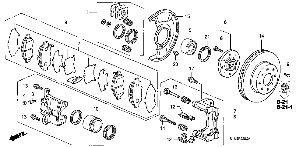

thanks doctor J. I did fit the shims back along with the aftermarket brake pads. The only problem I have right now is that there is an occasional "knock" or "tock" sound when I hit the brakes when driving uphill or downhill. Braking power is good, I stop pretty quick but there is just this weird "tock" sound on the brakes. Do you think it is because the shims is a bit loose? Is it ok to bend the shims a bit to lock it in place?

Most often knock is the sound of the pads touching the flat springs in the caliper bracket.(Position 12 on the picture) the remedy is to pull these spring s apply anti-seize or equivalent to the brackets and re-installing the springs and pads.
Sometimes the pad's backing plate can be shorter compared to genuine pads
