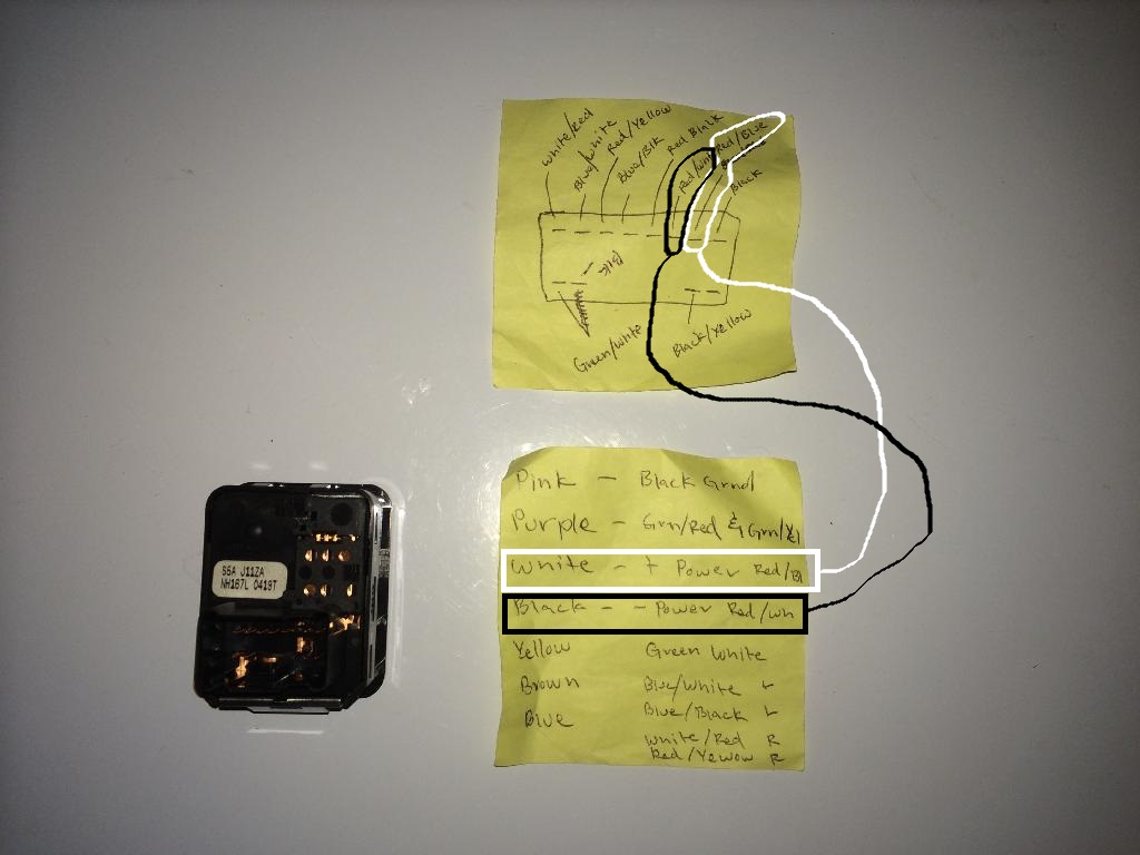

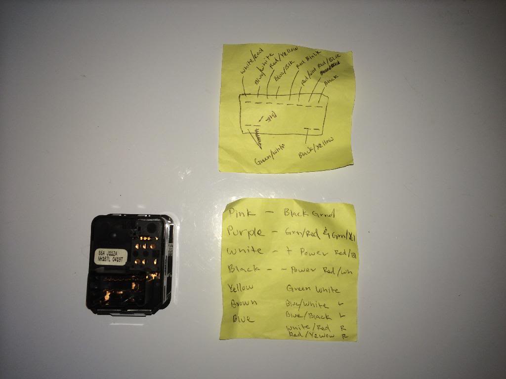

Any of you guys out there that have done a JDM power mirror conversion have the wiring diagram for the JDM switch? I haven't been able to find one with the same colors for wires that my switch has.. any imput would be appreciated ;-)

Dunno if you figured it out yet, but this is the pin callout I made when wiring up mine when I had them.
Obviously the wire colors depend on what you're using on your switch pigtail and your power folding +/- leads, but the pin location is correct assuming you have the power folding JDM switch.
Hope this helps anyone who may also be wondering.
