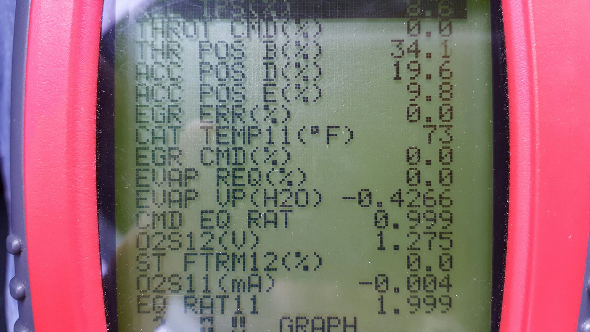

Here is what I got with the engine off after a very short drive.
Old Mar 2, 2017 | 03:43 PM
doctor J's Avatar
Posts: 1,606
From: Orange, CA, USA
O2 sensor 2 voltage is correct
EQ ratio (11) is 1.999 which is correct.
a spacer is installed to minimize O2 fluctuations in ehxaust stream near secondary O2 sensor
perhaps AFR sensor may need to be looked at
