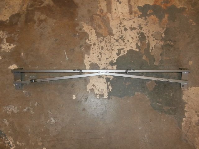

Originally Posted by Brian Hasty
We test fitted the new cable ends using the stock cables as this seemed like the easier solution than using the RSX cables. Pic of new bracket attached. We will probably make new brackets for the RSX cables as well for those who have already purchased that cable type.
SWEET!!!
Does this also allow using the Right side caliper on the R instead of having to switch them?
Availability of those parking break cable brackets? I need them as soon as they are available pretty please!

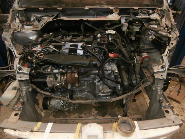

Sorry to not have kept updating on the Fit project, but we have been busy trying to get it ready for the Eibach event May6.
The L15B is finally in the car and we are proceeding to install the new radiator, AC condensor and the intercooler.
Today I deleted the clutch valve for a braided steel line with the assistance of Hush Perfomance. If you don't know who they are, they make custom tucked clutch and brake line conversions, mainly for show cars and the like. More pics coming of the installation as we progress.

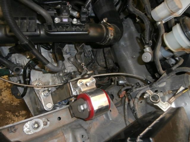

Here's some more info on the L15B7 turbo engine swap. We have the engine in it's final place and are proceeding to get the rest of the things done. I've attached some pics that will answer some more questions such as what shifter and cables we will be using, what radiator and AC condensor can be used, as well as the IC location and plumbing.

Hasport engine mounts should be available in the next 30 days or so. All the other brackets we are making for the shifter and brake cables should be ready at about the same time. Rather than release them piecemeal it was decided to get them all finalized and released all at once.
