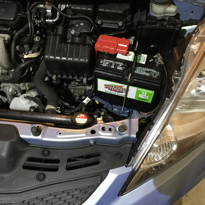

The Slight Angle installation seems to work fine. I removed the small battery with a tray changed the air filter put the 51R battery slightly sideways added battery terminal shim to the positive terminal. Tie the battery down. Started just fine -10F. Honda Fit Sport 2009.
