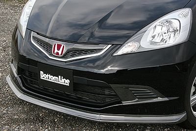

Hi there!
my 2010 GE Jazz got badged a few months back & I’ve figured I might take the opportunity to upgrade my front grille at the same time. Any suggestions on grille options? I’m pretty new to Honda’s & haven’t had much luck at finding things online thus far. I quite like the look of the image below, but the listing seems to be only for the ‘finisher’, not the whole grille, badge, chrome trim etc.
Any suggestions here would be appreciated!
I’m also finding that the Jazz rolls a lot through corners. Any suspension suggestions that might be worth looking into to firm things up a bit? I’d be happy with some lowering & stiffening, but not essential. I mostly want the car to feel more planted in the corners. Affordable options would be great!
