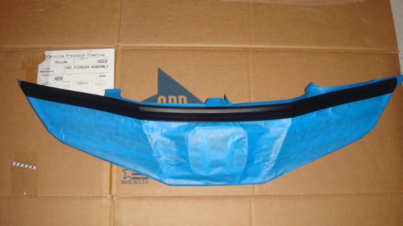

step 3: mask everything off.

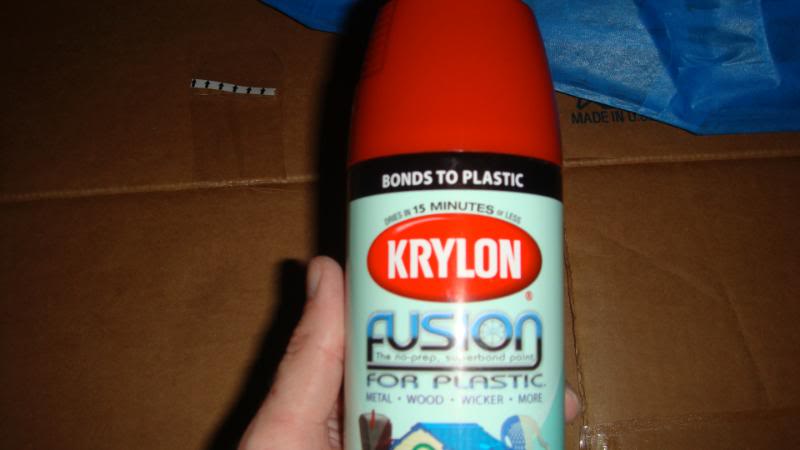

step 4: use krylon fusion. this chemically bonds to plastic to help avoid chipping.

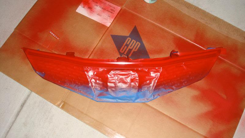

step 5: lots of light coats. this avoids runs. allow 20 min inbetween coats to dry. i prob did about 5 or 6 coats.

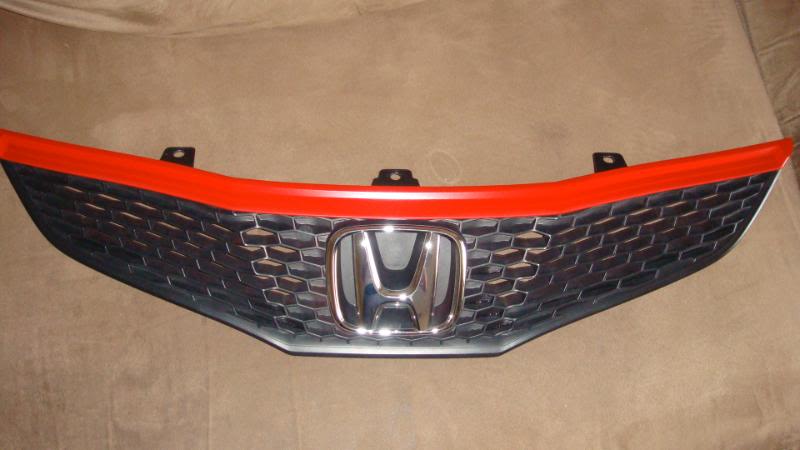

step 7: unmask and admire...

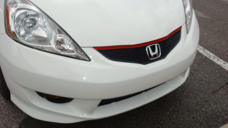

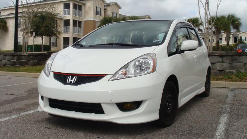

here's a shot of the final product on the car!

good link! the only "downfall" is that krylon fusion actually bonds to the plastic, the stuff in the link won't. but if you take your time prepping, it should still hold up.
