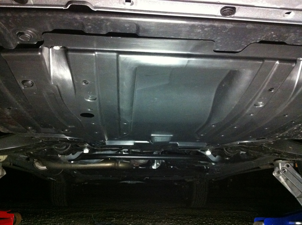

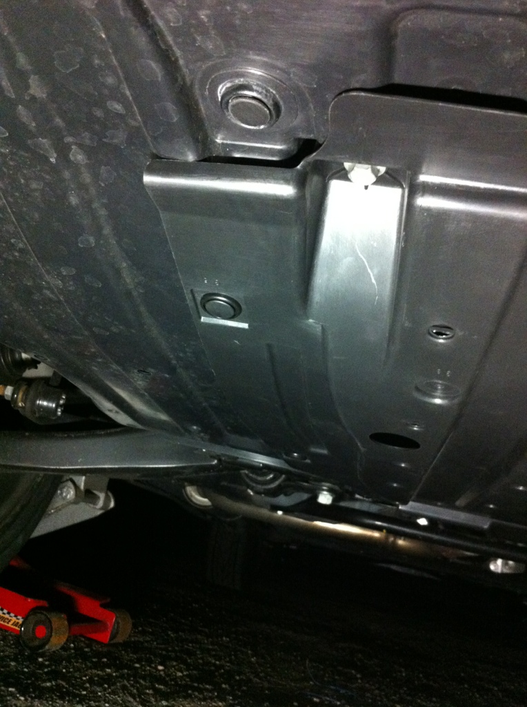

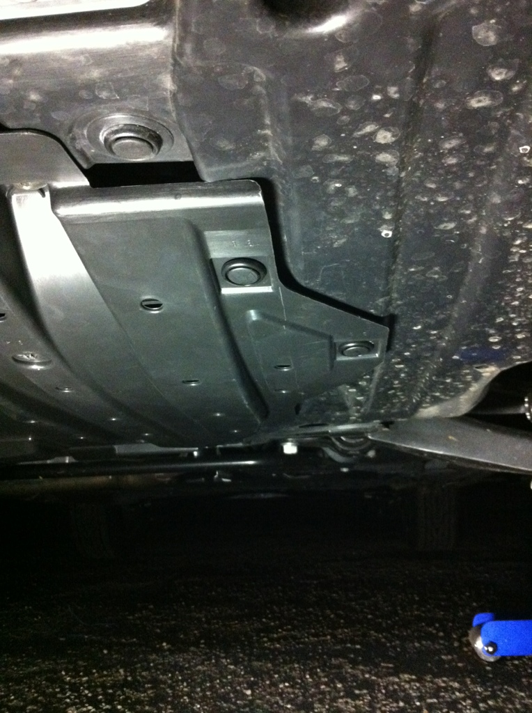

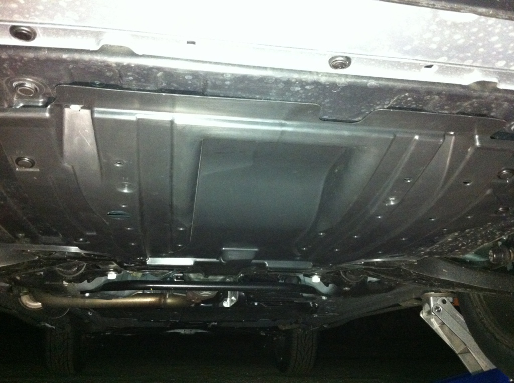

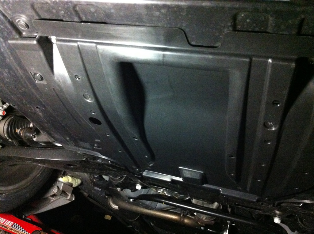

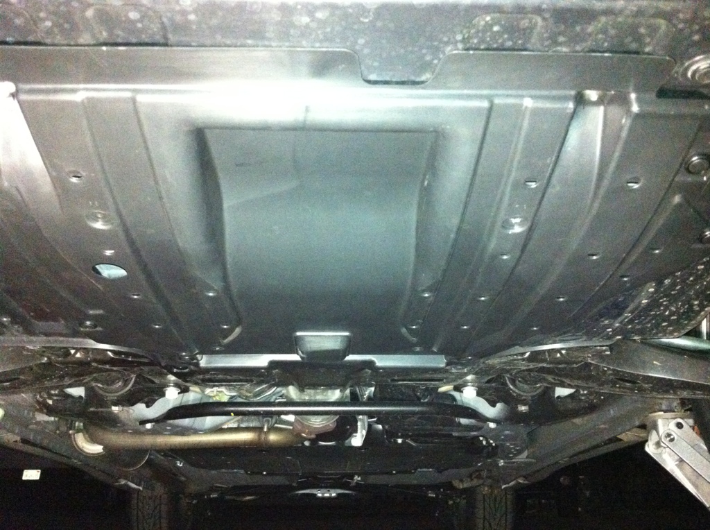

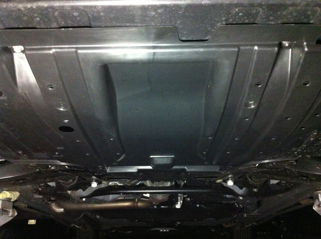

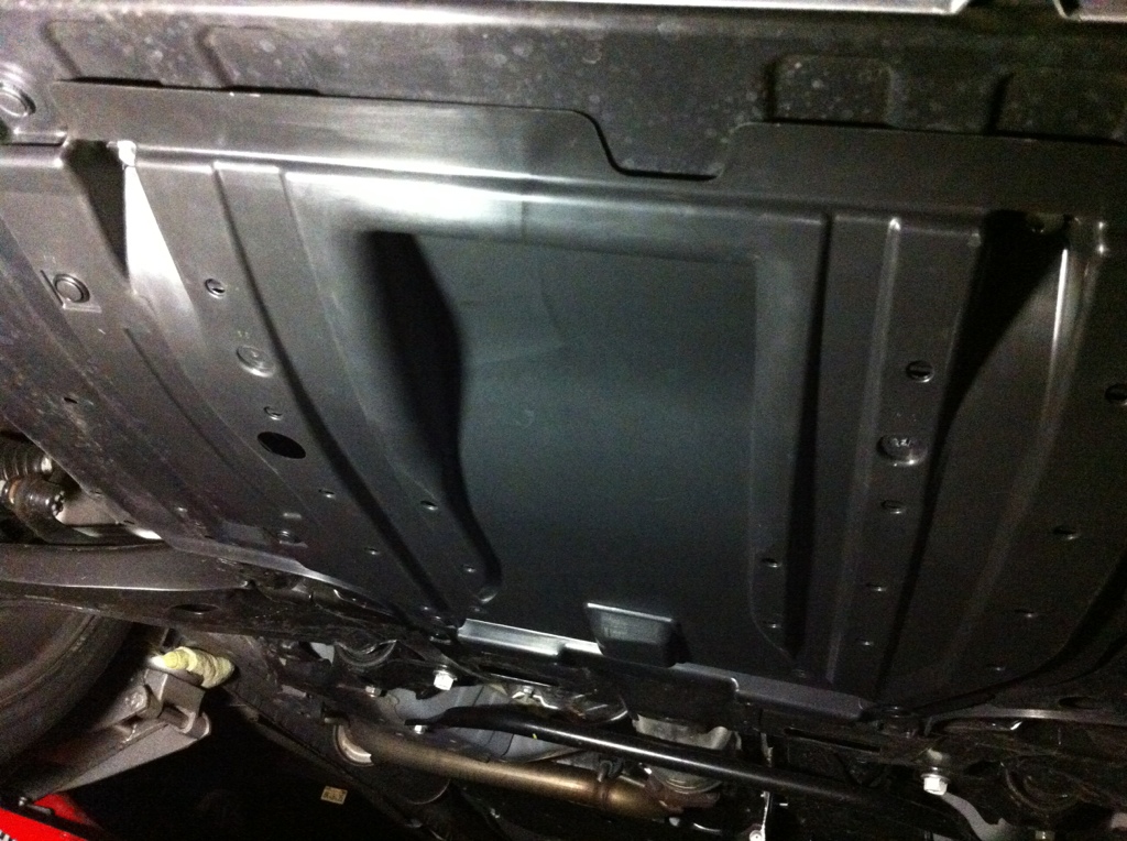

I used all the clips and mounting points the cover offerred, i basically drilled 7/64" holes through the existing CRZ cover and popped in snap clips (clips sourced from Toyota Camry lol). The 2 front screws are actually fairing screws from a Honda VFR800, this is neat because the screws have a fat blank unthreaded section that allows it to be tightened without stressing the plastic or over torquing it. The front 2 screws mounts do have threading from the factory that lines up, what you have to do is drill holes through the factory Fit plastic under panel and you will see 2 metal tabs that has threads that already exists. I noticed the Insight has the same type of cover as the CRZ but different part# i wonder if that one will offer a better fit then the CRZ one?

Worthwhile mod that nets me 0.8~1 mpg over the course of my 230 miles this week of highway driving so far. I drive the same distance and same routes daily so its very consistent.

Do you have to remove the panel to drain the engine oil? From photo angle I can't ell how far back it goes.

Yes it needs to be removed but its super easy as most of it is pop clips with a flat head and just 2 allen head screws towards the front.

Ok now that i went through a tankful of gas and something interesting has came about. With my new Kosei wheels and tire upgrade my city mpg went up 2.3 but highway mpg went down 1.1mpg , but with this new under panel it became a wash for the highway loss. Overall mpg has gone from 39-40 mpg (in the last 7 fills) to now a 41.7 mpg under the same driving conditions over the same road..
