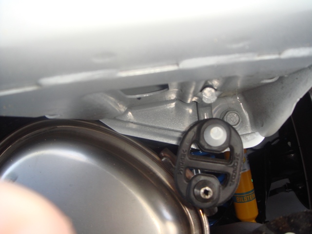

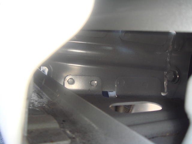

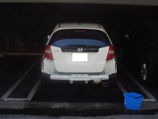

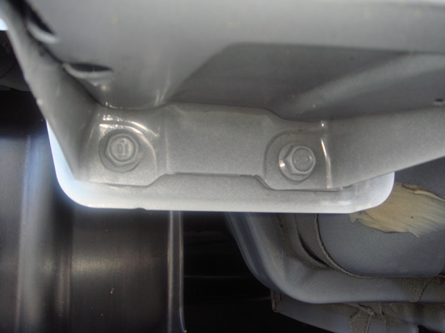

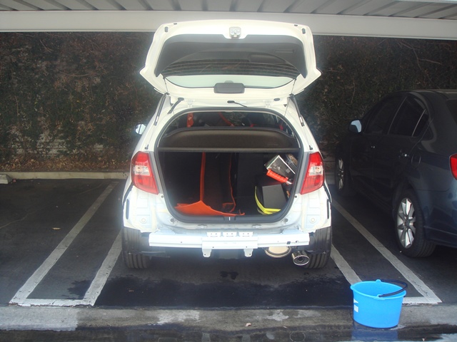

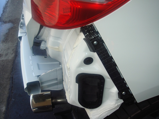

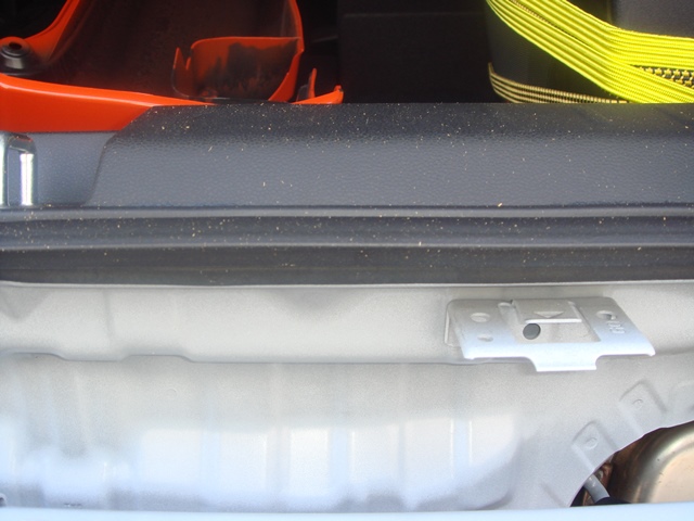

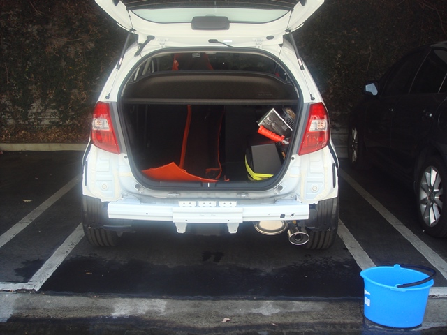

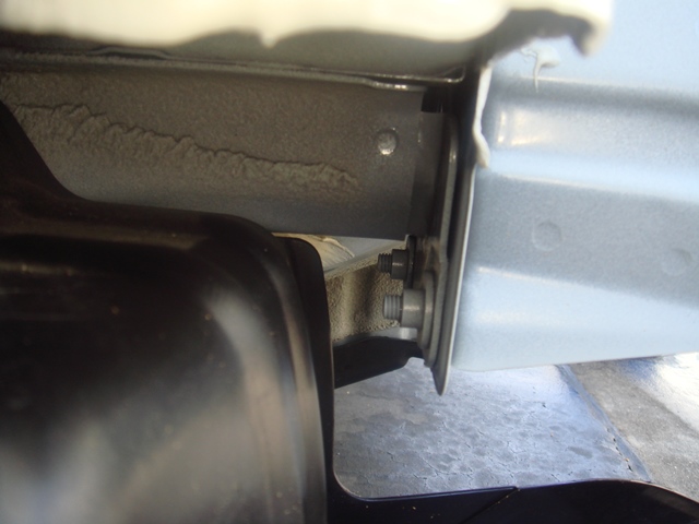

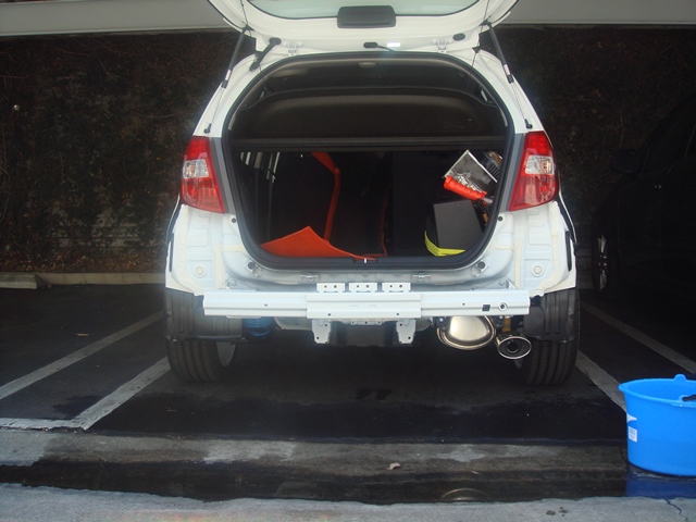

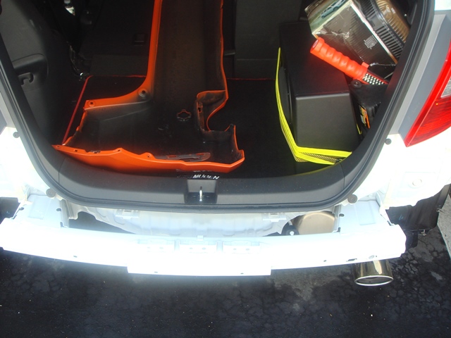

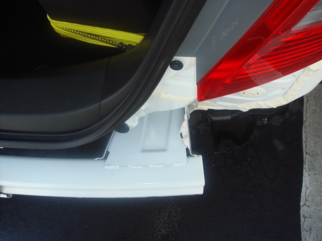

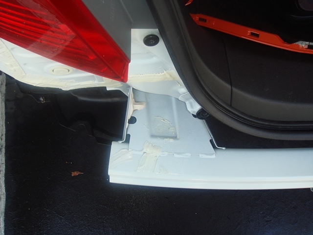

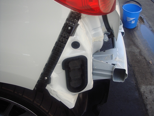

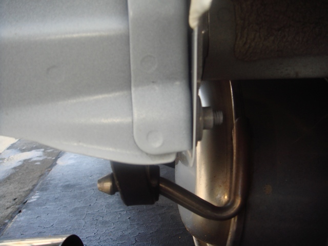

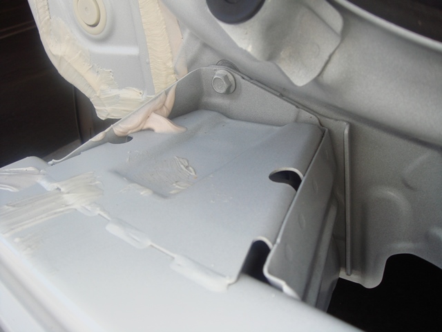

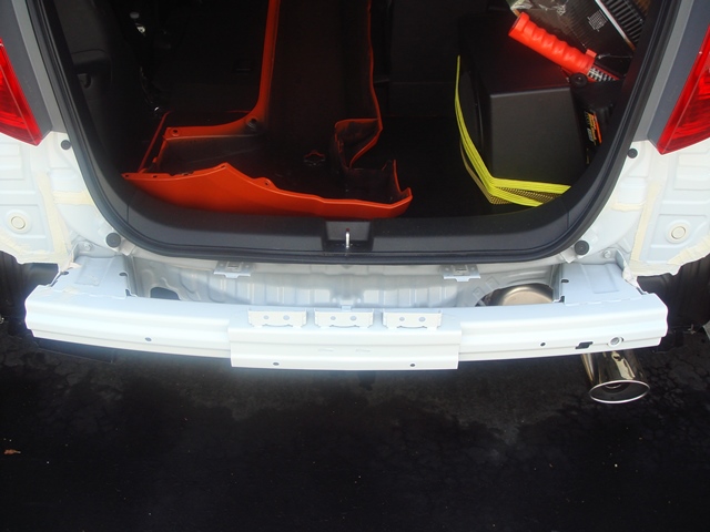

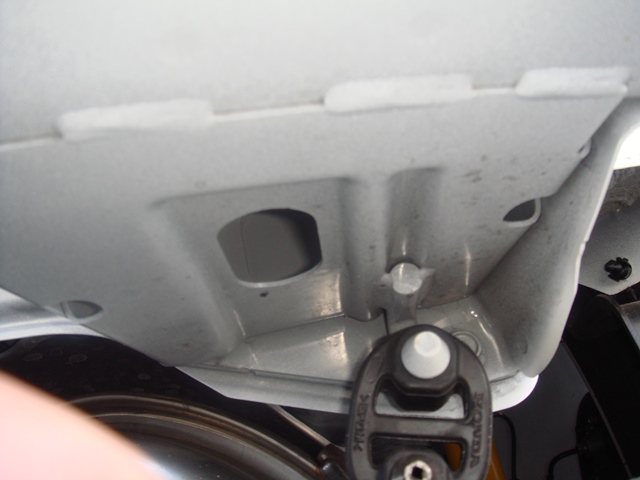

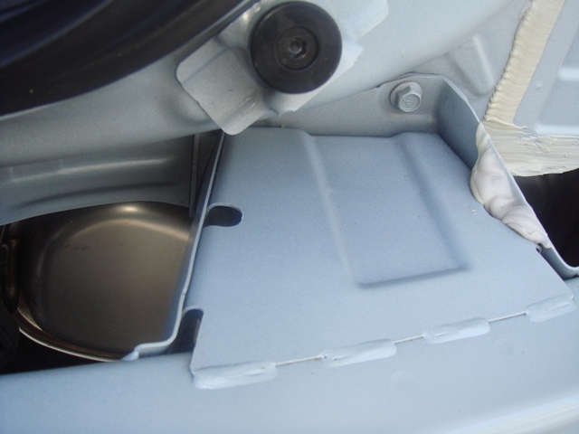

Ok,
Today I took off my Rear Standard USDM Bumper,
because tomorrow I plan to take my car to the body shop and
install/paint my JDM RS Rear Bumper
Here are the (MANY) pictures AFTER the bumper were taken off,
and this pictures should clearly shown the Reinforcement Bar that needed to be modified.

Old Jun 10, 2013 | 09:32 PM
cjecpa's Avatar
Posts: 2,667
From: Binghamton, ny usa
Does it just unbolt?
Old Jun 10, 2013 | 09:37 PM
BMW ALPINA's Avatar
Joined: Jan 2013
Posts: 2,449
The reinforcement bar ?
Yes, it is just bolted on to the chassis,
but I don't want to just unbolted it for 2 reasons:
a. I want to still have the added protection of the reinforcement bar,
even though the JDM or other country version do NOT have any reinforcement bar (I check, no part diagram (any country) show rear re-bar).
b. The Exhaust hanger were welded to the right leg of the reinforcement bar,
so it is better to keep it that way, rather than welded the leg to the chassis directly.
What I will do is ask the body shop to cut the 2 leg, make it shorter and welded it back again to the reinforcement bar,
so the reinforcement bar will be closer to the chassis of the car.
hopefully there is enough room then for the thinner "butt" RS Rear bumper.

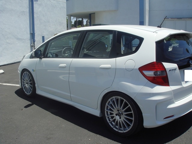

Old Jun 11, 2013 | 10:03 PM
  #32
buckeyeFit's Avatar
Joined: Jun 2013
Posts: 23
From: Central, OH
in for results
Old Jun 14, 2013 | 04:25 PM
  #33
BMW ALPINA's Avatar
Joined: Jan 2013
Posts: 2,449
Originally Posted by xTravisxEdgex
Jesus. This looks glorious.
I wish you the best of luck with your project.
Definitely worth the hassle.
Originally Posted by buckeyeFit
in for results
Thanks Guys,
I just return from the body shop and I love the "slimmer" butt looks
but I am restraining my self from posting the picture today, until
my front and rear JDM "RS" emblem that I had been ordering from A-J Racing since early February arrive by next week
you know, just want it to be picture perfect with the rear "RS" emblem installed
Well, UPS say the "RS" emblem had reach Seattle now, so
hopefully by Monday evening I already got it

Old Jun 18, 2013 | 09:02 PM
  #35
BMW ALPINA's Avatar
Joined: Jan 2013
Posts: 2,449

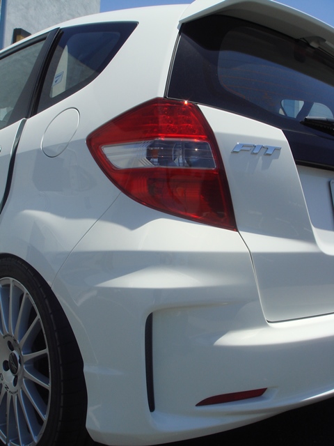

My RS Emblem would not arrive until late evening tomorrow,...
so I take some pictures as "sneak peak" hahaha
but I will took the complete rear picture only after I install the RS emblem
Size:  106.0 KBName:  DSC06829_zps448b5658.jpg
Size:  95.1 KBName:  DSC06831_zps61b356c7.jpg
Size:  127.1 KBName:  DSC06828_zps7f4dab0c.jpg

Old Jun 18, 2013 | 09:47 PM
  #39
BMW ALPINA's Avatar
Joined: Jan 2013
Posts: 2,449
Originally Posted by pocky
That looks SO GOOD! You need to stop teasing!!!
Wow I am envious of u right about now!
Hi Guys, Thanks for your kind words, but this is NOT perfect though...
Please Wish me luck so I can have more budget to improve the looks by putting
the JDM Mugen Infinite Rear Under Spoiler and then also buy the LED Fog Light for that Under Spoiler (but used it as Another Brake Light), now that would be perfect...
well, adding the top rear spoiler with Takero's carbon fiber extension lips would make it even more perfect...
unfortunately, the budget for the 2 above are still long way from being approved hehehe
so that mean still long way to go to reach that perfection for me
