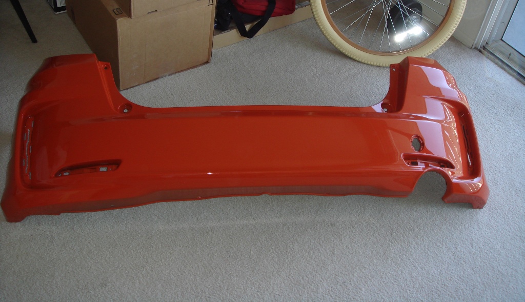

Hello,
My Friend happened to travel to Japan last week,
so he help me by buying the JDM RS Rear BUMPER (Latest Version) for me.
JDM RS do NOT came in Tafetta White color (only Pearl White),
so my friend bought me whatever color that is ready stock,
and I got this Orange Color.
Will have to paint it and install it later when I have free time
After I install this bumper on my car, I will update this thread again
in the mean time here it is:

From: Whittier,CA
pretty..........
Old Apr 9, 2013 | 05:59 PM
sr.sedan's Avatar
Posts: 499
From: CALI, IE
*********Nice*********
