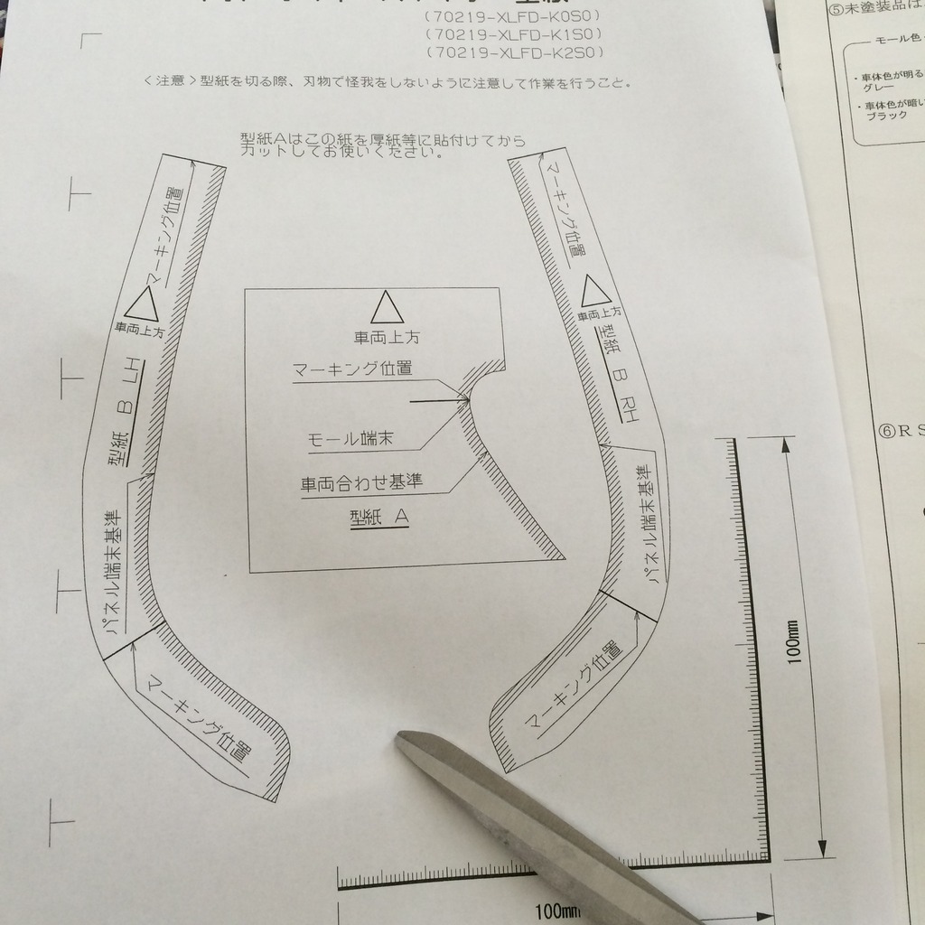

The Template provided from Mugen and Cut the template:

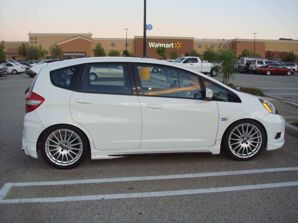

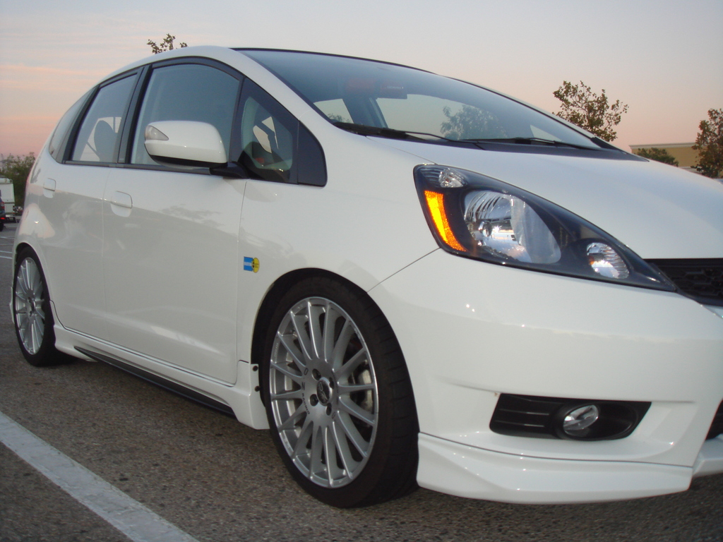

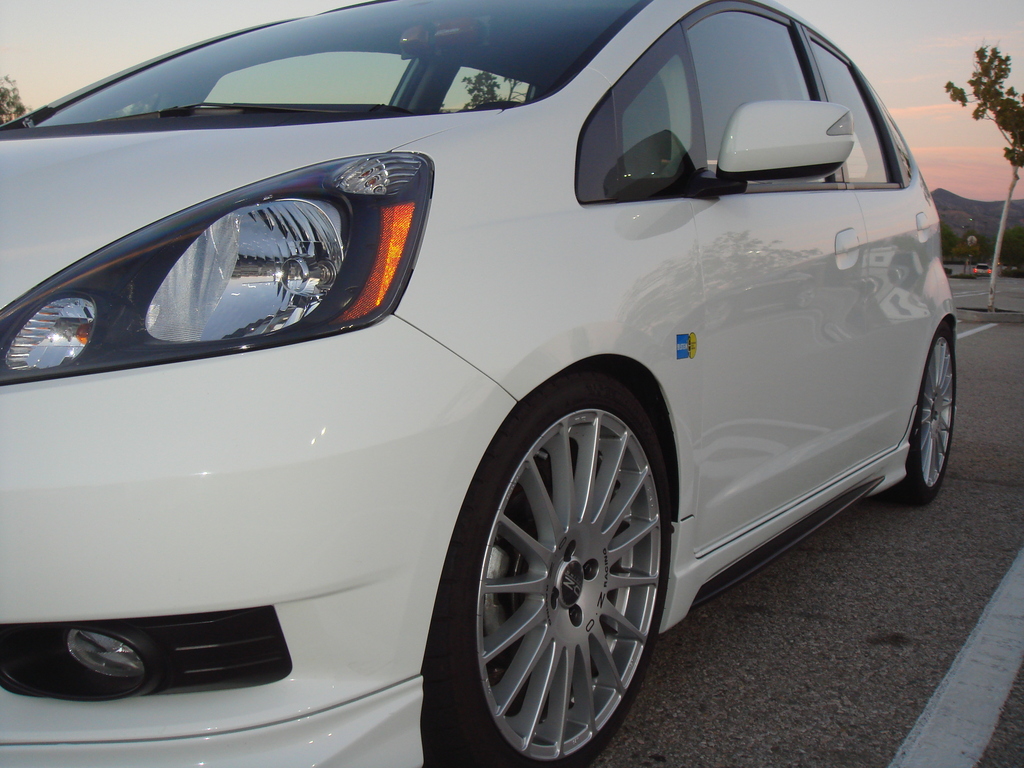

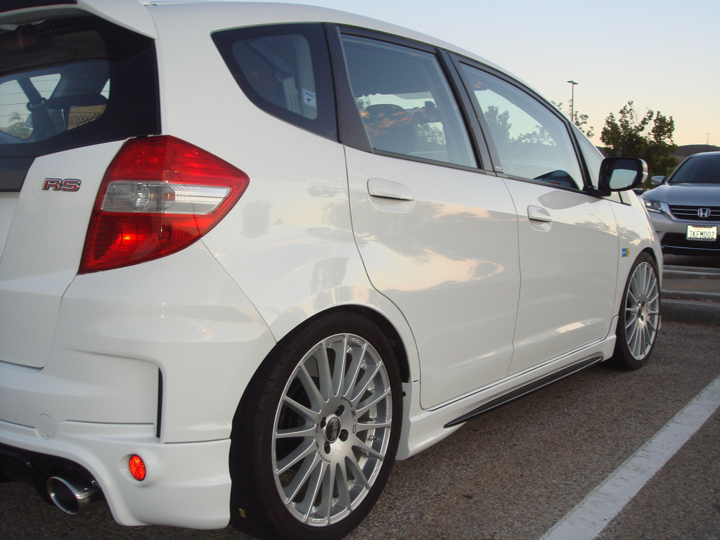

Take pictures outside
