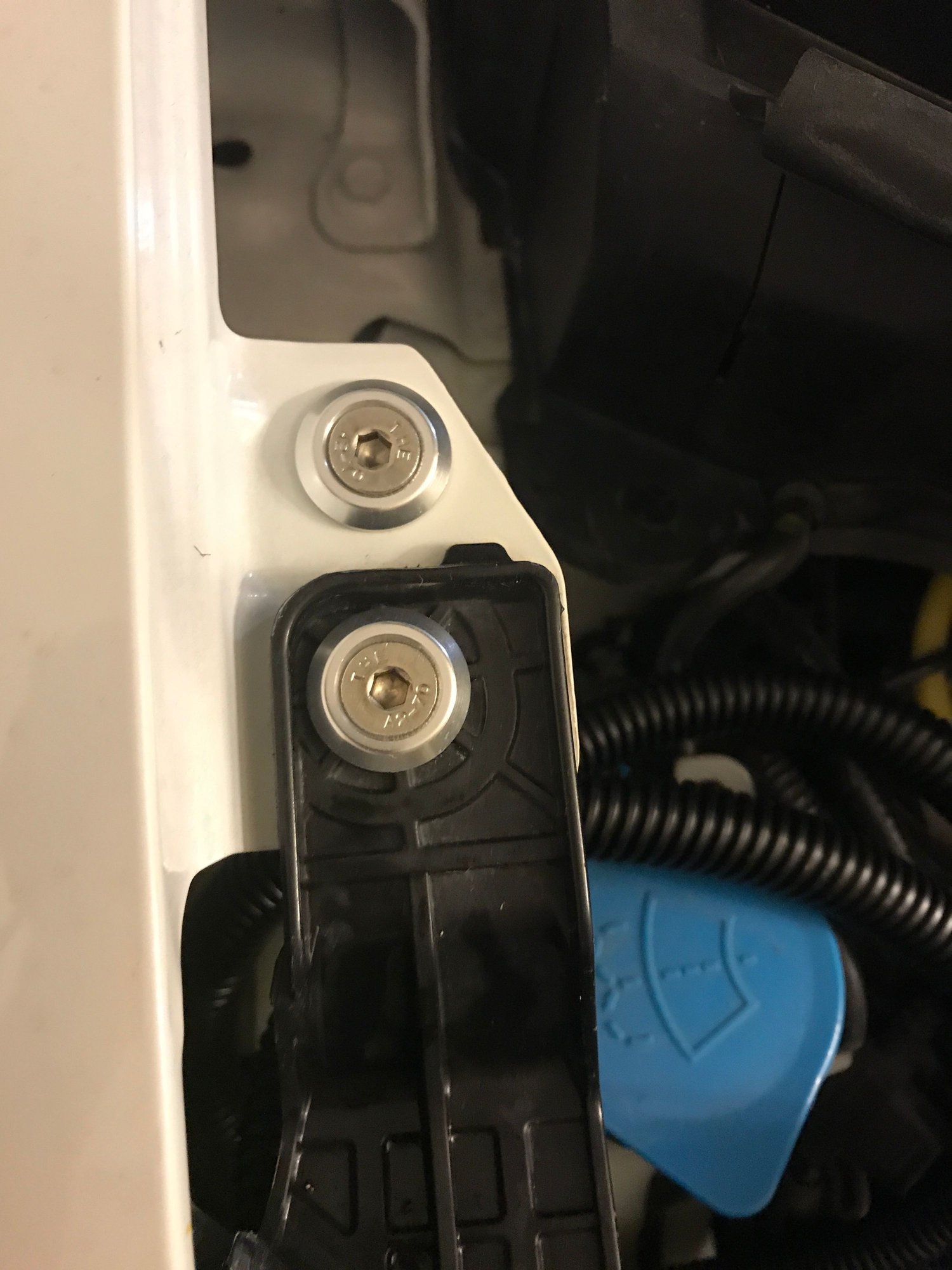

I got a free Fender Washer Package from Kuo's Garage long time ago (like 2 or 3 years ago) when I buy their front upper strut bar,
I just never figure out how to install them because they have this rivet nuts that I am not familiar with...
but since I am installing all the Defi Oil and Temperature sensor,
so I have to remove the front grill and JDP engineering Carbon Fiber upper radiator cover, I decide it's time to install those Kuo's Garage fender washer because I won't need to open this grill again since all the modification in that area is now completed...
After looking around, I finally figure out how to install it:
