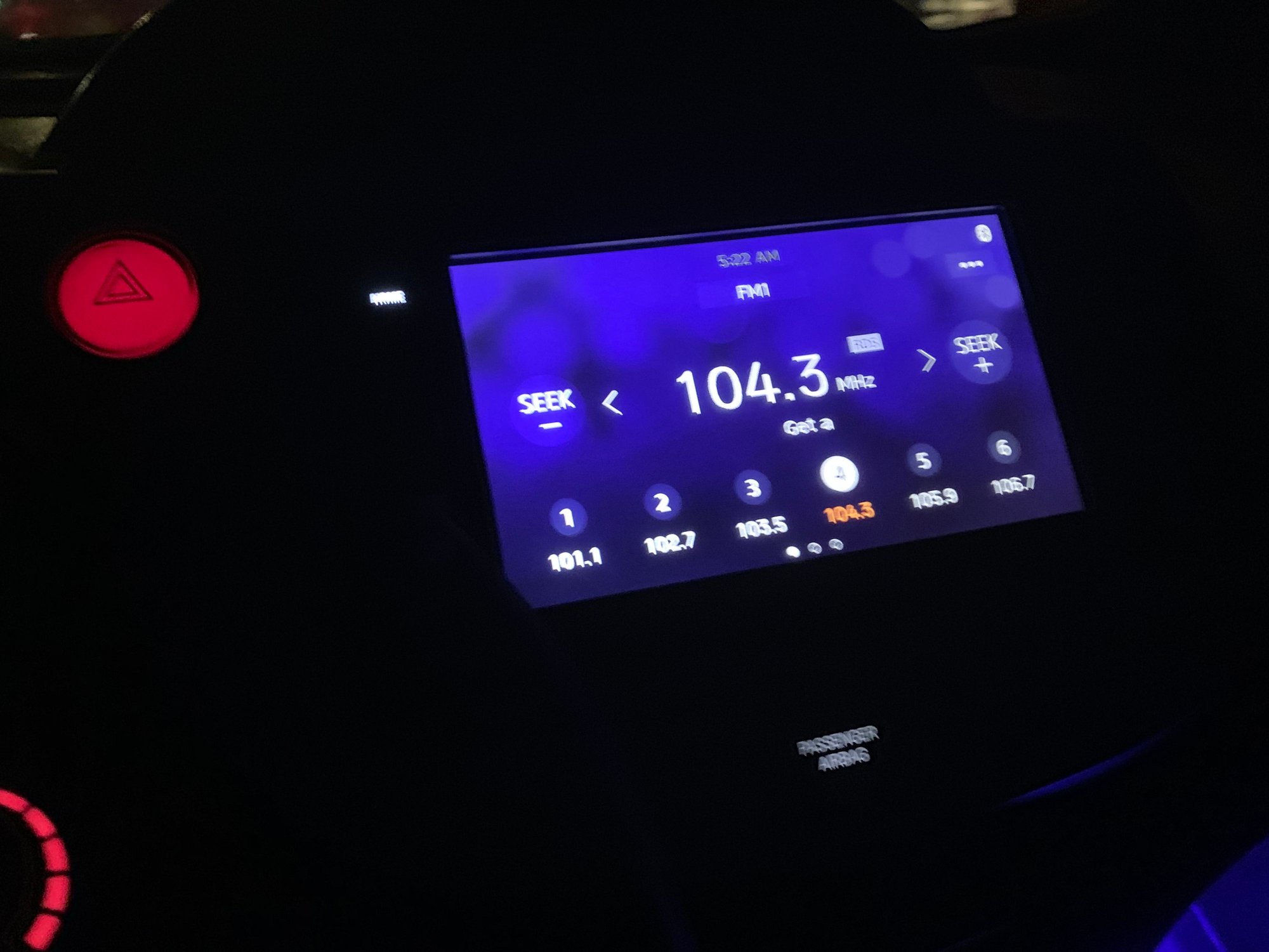

I felt the headunit sat in the Metra kit perfectly. I will snap a picture of it later when I get home. I did not think it needed any extra/different trim.

Old Aug 14, 2019 | 01:17 PM
changerrs's Avatar
Joined: Jul 2017
Posts: 18
From: Southern California
dang, that does look pretty good! thanks for sharing.

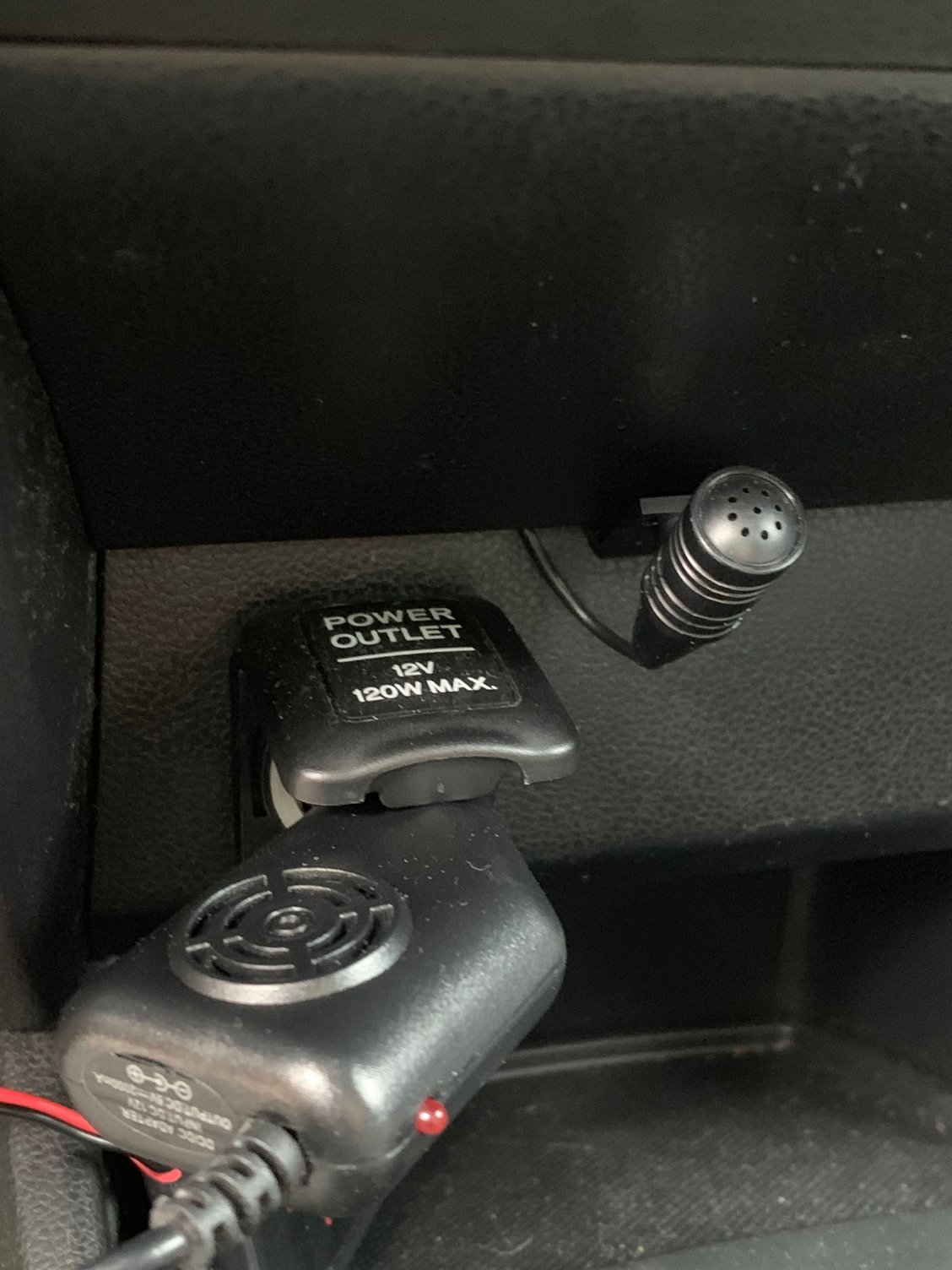

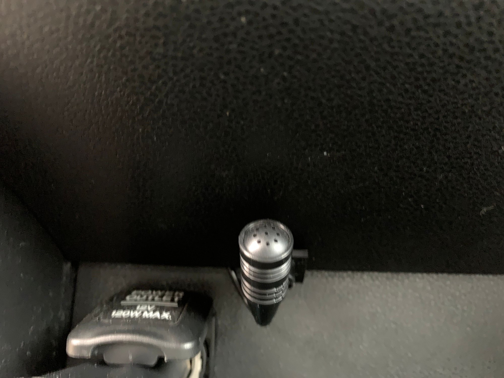

Old Aug 18, 2019 | 03:49 AM
changerrs's Avatar
Joined: Jul 2017
Posts: 18
Originally Posted by marmaladedad
Finally, I attached the mic for Bluetooth to the bottom panel of the radio (the one you first remove). It tested out great when I called my wife over the phone.
Where exactly did you install the mic?
Old Aug 18, 2019 | 10:59 AM
marmaladedad's Avatar
Joined: Mar 2018
Posts: 874
From: South Pasadena, CA
