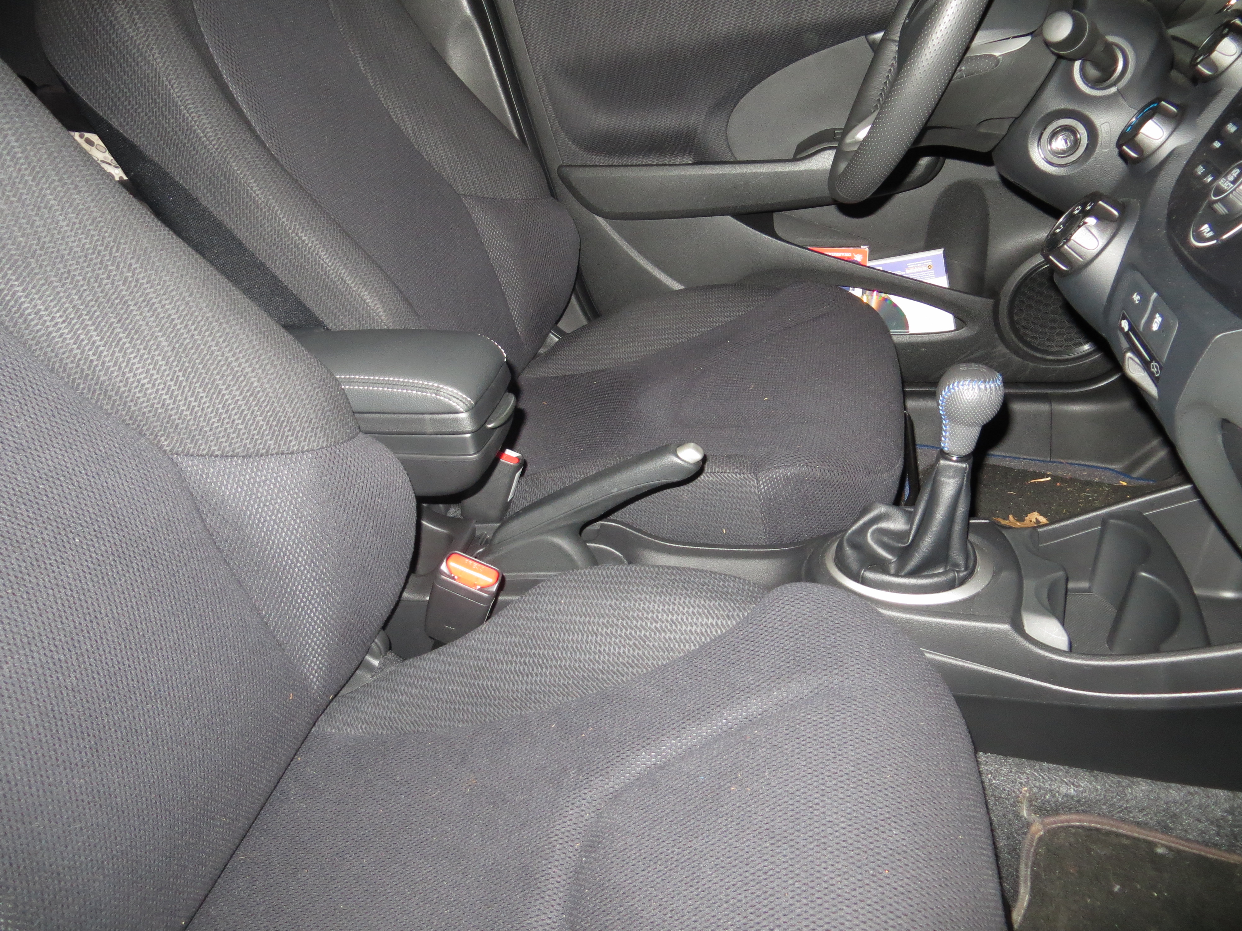

This is a great thread - one more question before I pull the trigger and get one-- is the height the same as the arm rest? I find it bordering on too high so don't want to do this if it is higher. The Picts suggest it is about the same but hard to know.

Probably 1.5 hrs all said and done (I was so eager I did it tonight in the dark after everybody went to bed!). Also used 5/16th and 3/4 wood bit and worked perfectly. Watch the video, get the instructions online and it's an easy satisfying beginner DIY, and great addition to car. Despite reading these threads I also had trouble with starting the ebrake cable bolts (including having one roll under carpet- you'd think I'd have learned!- stuff a rag in there or have a magnetic extension tool handy).
Very impressed with quality and color match is perfect. And to answer my own question, it's height is actually about an inch lower than the arm rest (and no issue with MT).

I noted in an earlier post that I installed one in my '13 Sport and that the color matched perfectly, to which mezzanotte asked how I got one that matched a Sport interior.
I asked my wife, and she reminded me that I am, ah hem, "chromatically challenged" and colors in my world are not exactly how they are in others' world ("color blind" is so derogatory!). So maybe I need to back pedal a bit. I'm told the match isn't perfect. I'll try adding a pict for you all to see.
