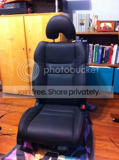

BTW if got some more goodies to share with you guys. Wrapping the seats in leather and adding heaters Seating perfection is near. I've got the passanger seat done, and while not technicaly difficult to do it was one of the most frustrating projects Ive attampted for the fit (I think my hands will be sore for a week) . pics soon...

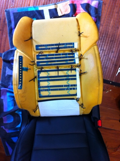

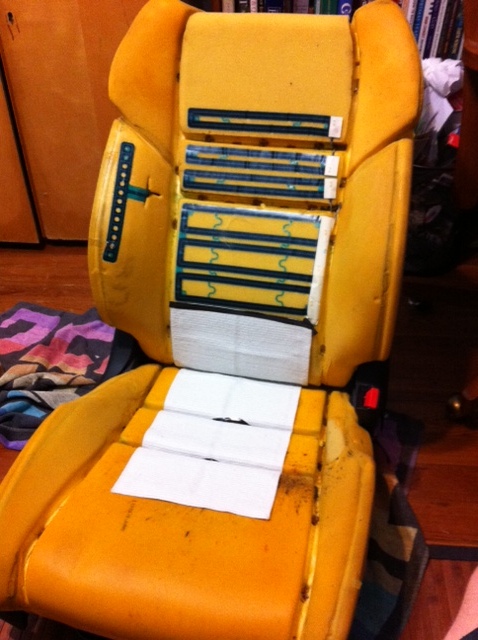

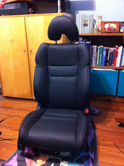

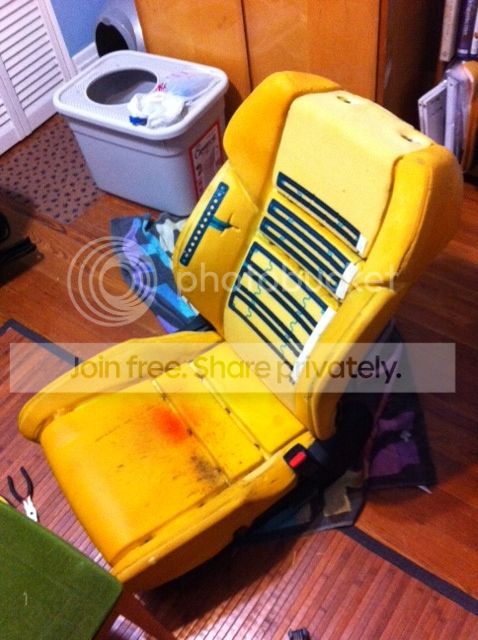

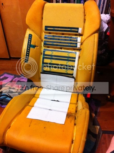

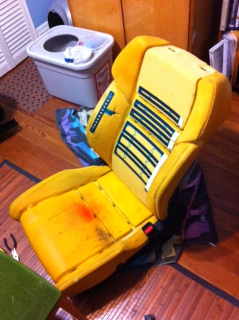

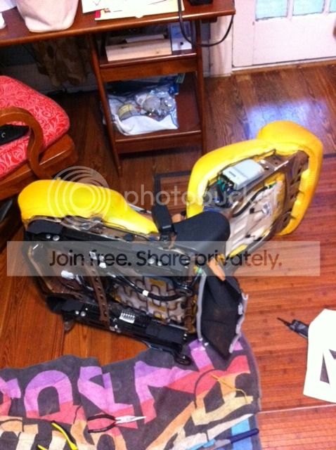

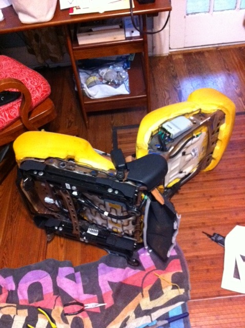

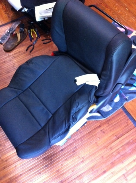

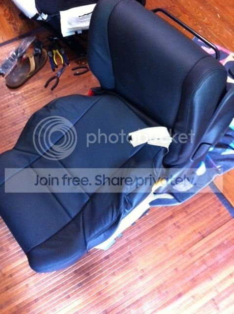

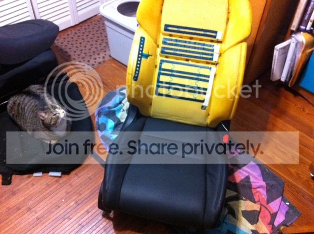

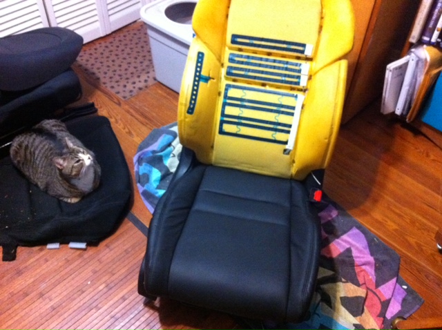

here are some pics of the passanger seat. I still need to attach the new feet and get it installed.

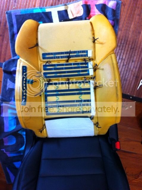

Heating pads installed. *note the Occupant Detection Sensors. Dont cover them with pads.

You wrapped the seats with the Katkins, hog clips & all..... yeah your hands will be sore for a while...
Great job on the mod w/leather & heating...
I'm really thinking of trying this out with the Si seats eventually & see if I can install the cooling fans. Otherwise might just go with one comparable Recaro for the drivers side cause that's going to be $$$$.

heating pads installed. *note the occupant detection sensors. Dont cover them with pads.

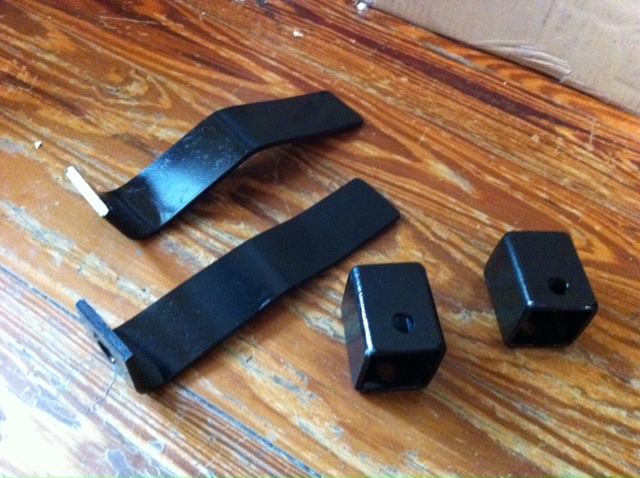

I got the passanger seat installed over the weekend. I'll try to get a few pics up of it installed this evening. It sits about ~0.5-1" higher than stock because I didnt hack off the front brackets but rather extended them.
Everything was plug and play. I moved over the Fits buckles because the guy I had bought these from had changed them.

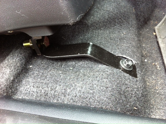

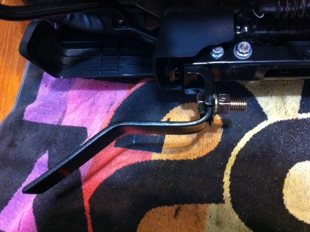

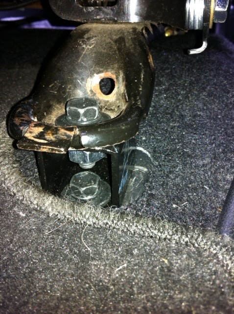

Here are the brackets and how they are attached.

BTW; the rear brackets I made are 1.5" square steel tubing with holes drilled in either side. The tube was bolted to the floor using the OEM bolt and then the seat bracket was bolted to the tube again using another OEM mounting bolt. The front bracket extender was attached using a 1/2" dia. Grade 8.8 bolt and then atatched to the floor using OEM bolt.
I also changed the washers out on the drivers seat after figuring out the lowest height I could get and replaced them with 2"x2"X0.75" solid steel blocks with 10mm holes drilled into them.
Another interesting thing that i found was that the OEM Fit passanger side seat has its feet attached using bolts instead of rivets. i.e the same way I attached the my front brackets on the drivers side.

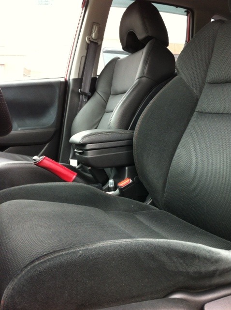

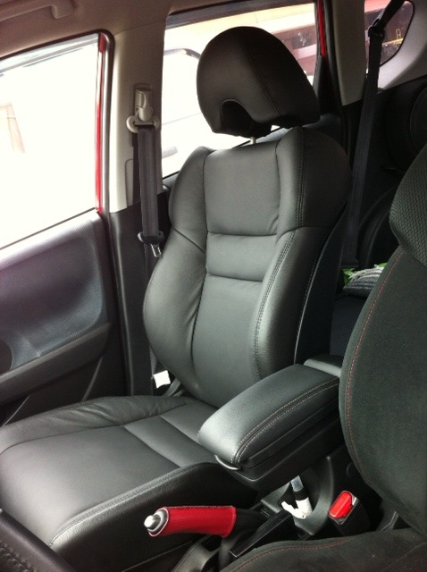

Okey, here are a few quick shots of the passanger side installed. The color of the leather is just about a perfect match for the OEM center console.
