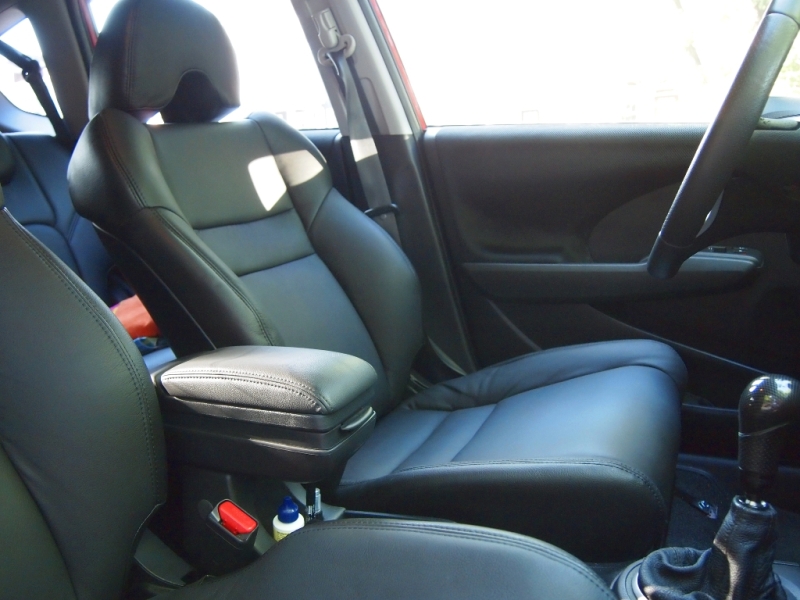

Got around to wrapping the drivers seat in leather last weekend. Sooo comfortable, feels like a different car. Just have to put the fit plastic covers back over the feet to clean up the look.
Old May 30, 2012 | 11:32 PM
  #50
Potenza's Avatar
Joined: Mar 2012
Posts: 152
From: Indianapolis
Originally Posted by jcuecker
I got the passanger seat installed over the weekend. I'll try to get a few pics up of it installed this evening. It sits about ~0.5-1" higher than stock because I didnt hack off the front brackets but rather extended them.
Everything was plug and play. I moved over the Fits buckles because the guy I had bought these from had changed them.
So the airbag connectors are all plug-and-play? The occupancy and side airbag sensor all plugged right in with no modification?
Seats look excellent BTW. If it really is a plug in affair on USDM models, this will be the only thing that saves my future Fit ownership.
