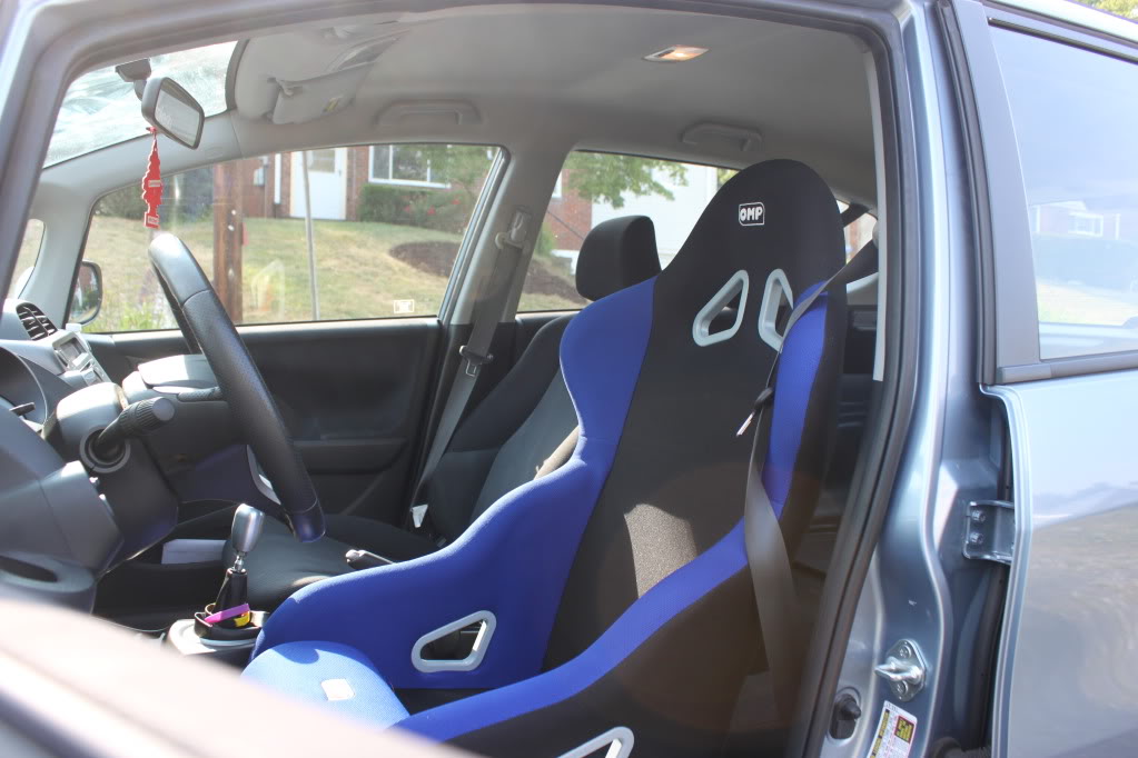

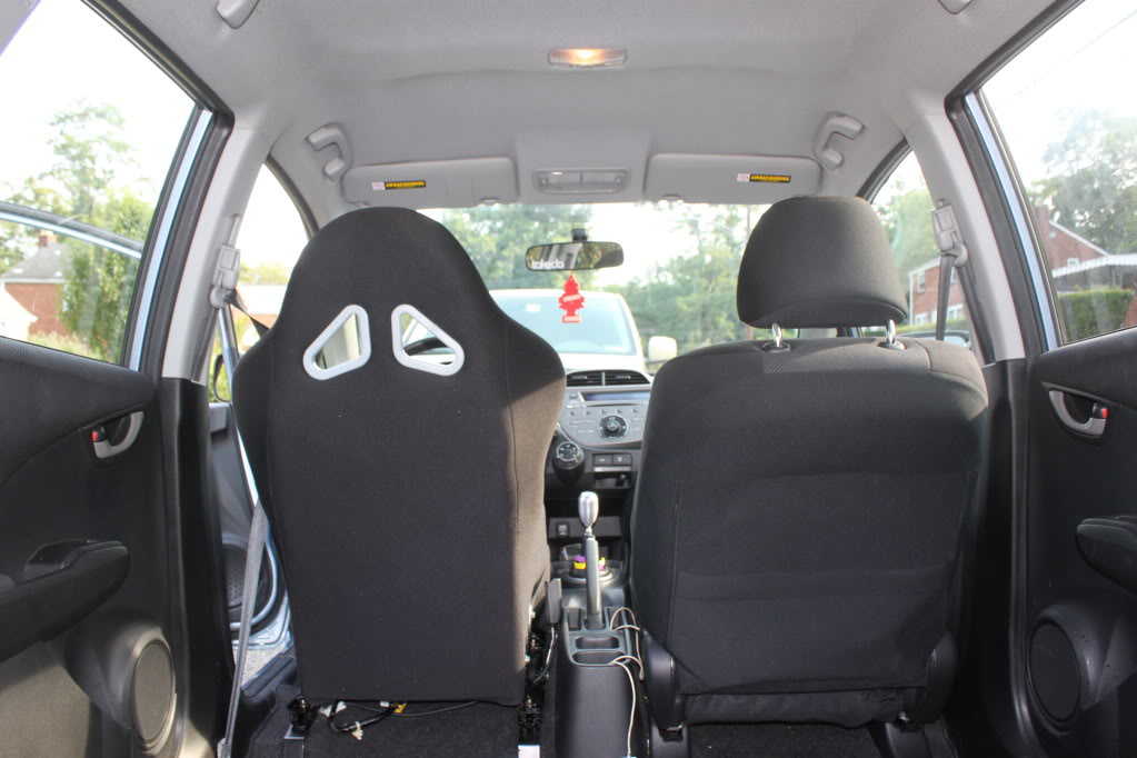

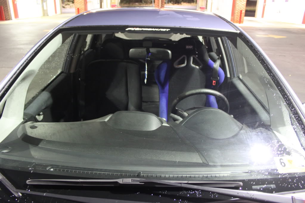

Sorry for potato quality pics. I like the seat very much, even though its a pain to get into and out of...it's something I'm used to from past cars but not every person likes riding around in a fixed back race seat every day. It does sit much lower than stock, and the seat bracket contributes to the low height. The difference between this and stock is night and day...I get into stock Fits and it feels like I'm in a truck. Just awesome around turns.

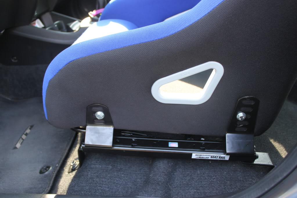

I'm using the Buddy Club Super Low bracket seen here. You'll get an airbag light if you don't use some sort of resistor or jumper wire on the airbag plug. Also, as far as the passenger side is concerned, there are position sensors on the rails which dictate how the airbags deploy IIRC...a big headache to deal with and it's why most people just keep the stock seat.
