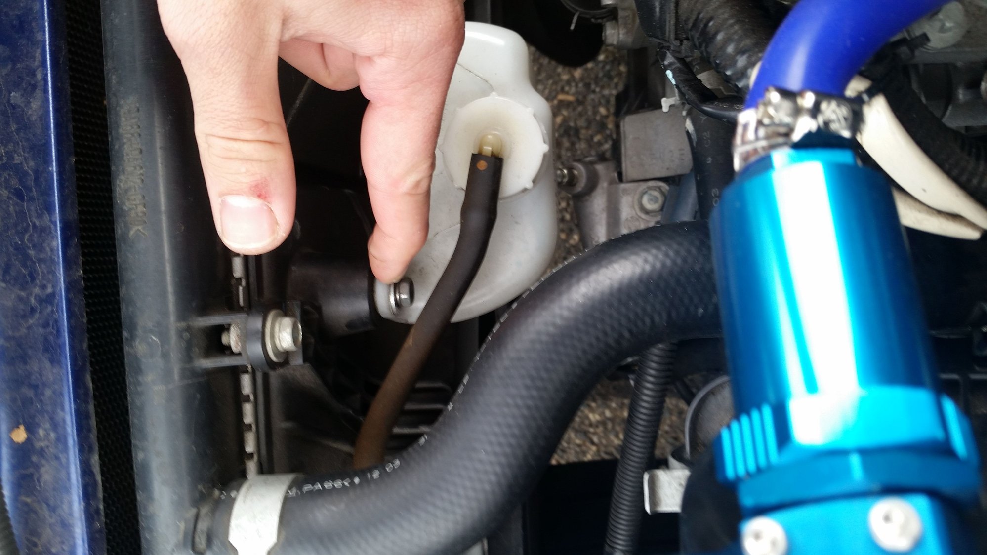

Okay, found a minute.
Theres your coolant reservoir. Based upon the perspective shown in the image you can see your coolant level on the lower left side.
Heres the single bolt holding it in place. Can slide the reservoir up if you want to get a better look.
Heres the coolant color. Keep in mine that the inside of the radiator is black and the reservoir.. well, the reservoir is young enough to still show the proper color.
Filling and checking the coolant is done only at the reservoir. It has a hot and cold line to indicate where the level should be based upon whether or not the cars been driven recently. This is a link for a step by step guide.
Edit: Click or tap on the image for the fluid color, the image uploaded weird.
