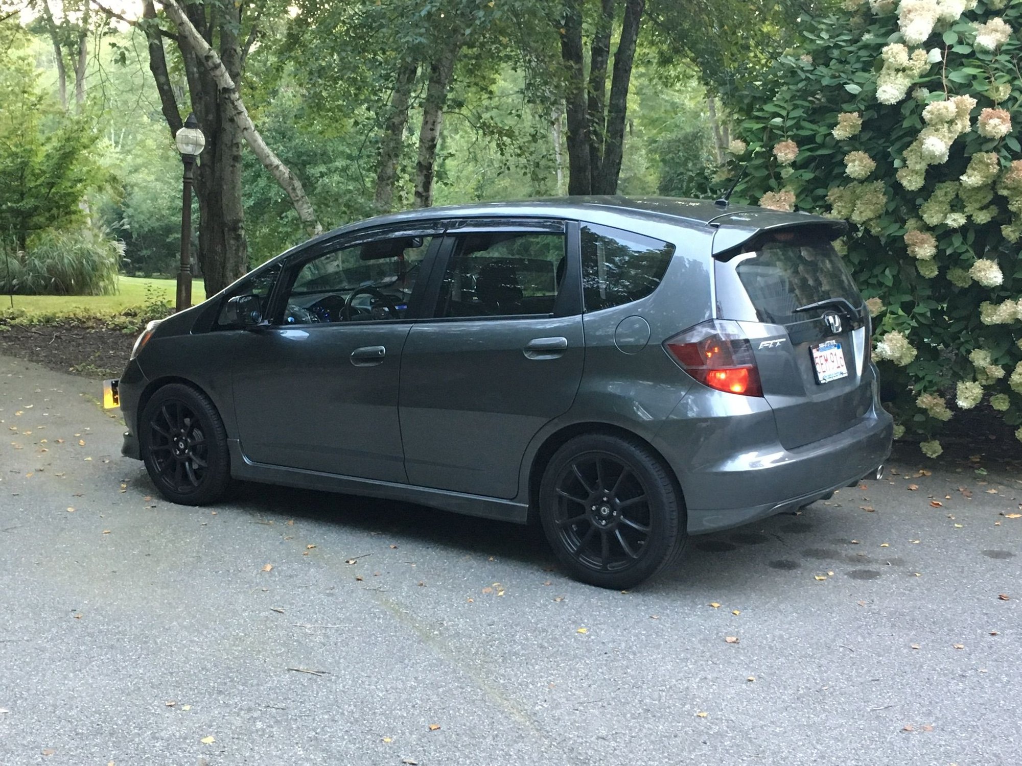

Get some Tein coilovers. Great smooth ride and you can get rid of that wheel gap.
Tein Flex with front fenders rolled.
Those HFP wheels look so proper!
