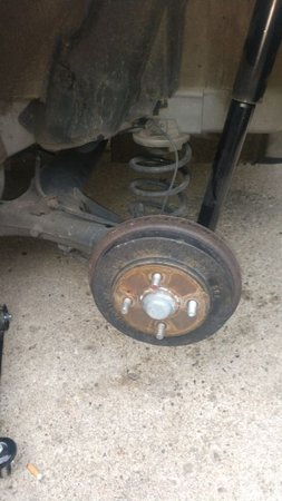

Thanks for the reply. My roommates a mechanic, albeit a poor one. He's advised me poorly enough times to not trust his word. For example, use compression fittings on a brake line leak 6 inches from the master cylinder in a 99 s10. Regardless he says my rear drums are out of round. I tend to believe him as I can see it kinda.
Big thing I noticed now though us a gap between the top, white plastic at the top of my struts and the place they mount to the car. Both sides, big enough I can get my fingers in there easy. Mounts are tourqed down well, so is that normal? Sorry for the plethora if questions, but I'm a computer tech, who's forced to do my own mechanics mist of the time.

There should be a gap between the white(ish) plastic and the car, as that needs to rotate with the springs without coming into contact with the car. On the top side, the threaded part of the strut should stick out something like 1/2 to 3/4 an inch past the retaining nut (which itself is pretty long).
What I find a little strange is seeing your bump stops. That's usually hidden under that black accordion like plastic cover. In fact, that cover should extend from the black housing of the strut to the spring cap, as its job is to minimize getting any dirt/debris on the inner shaft.

The OEM retaining nut, which I assume is the one on top of the black, castle top looking rubber thing not in my pictures, was rather tall. The one that came with my struts is not. Basically half the size, so I assume it's correct as there is well over an inch showing through.
And I sure wish I'd have read your response before I tore into lol. Now I'm sitting here looking at my knuckle zip tied to the body so my CV doesn't pop out, both sway bar links still attached because I can't find a set of vice grips in my mechanic roommates garage, and thinking, dang, now I've gotta put this back together again.
As for the bump stops, I don't know. First time dealing with it. The way it sits in the picture is the way it was out of the box, but when the car is lowered, it sits directly inside of the top section of the strut, with the accordion plastic beneath it. Not sure if it matters or not, but the whole things slides up and down freely.
