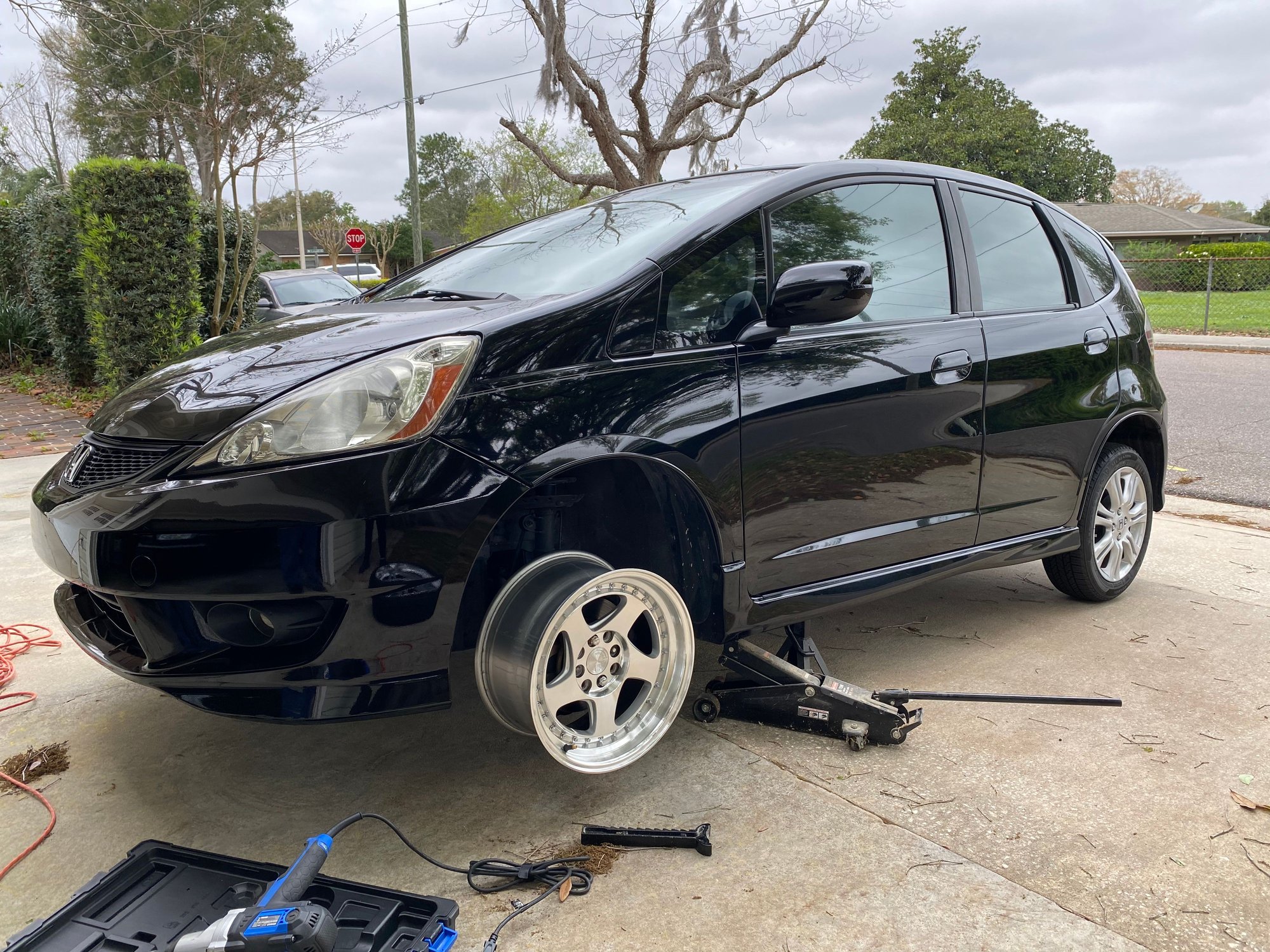

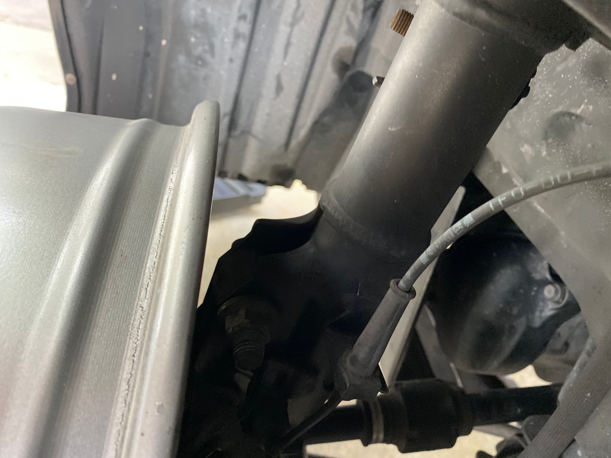

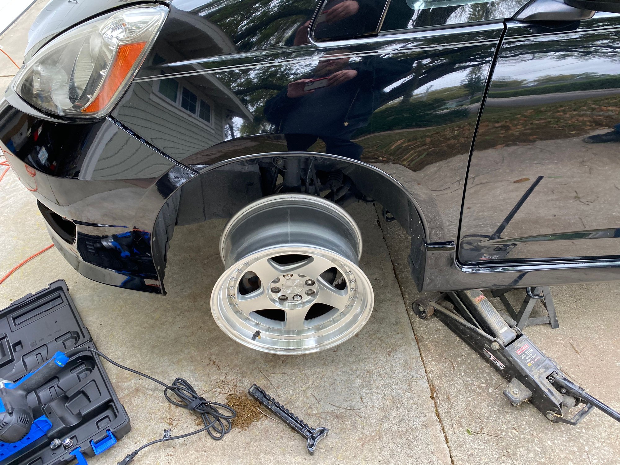

to update the thread I bought 205/45R16 tires they don’t rub. My offset is insane at +15 there is a slight anoint of poke will post pictures as soon as I get them remounted as I took off for a balance. Any one thinking about running this aggressive of a wheel set keep in mind everything about them doesn’t really agree with the cars stock look I most likely will have to roll and pull fenders but it should give the lil fit a mean look.

Update back to stock shit got really sketchy and studs where broken. In the end back to stock we go.

im financially dead but physically alive and the car was not crashed lol but it snapped 2 studs clean off messed up some bushings think I might have a blown shock assembly. and ultimately cost me way more to fix the problem I made driving on them for a week. I would recommend sticking with shop specs for wheels never will I ever stray again.

The deviation from the OEM wheels aren't the issue.
You went with bad wheel sizing, yes, absolutely. However a reasonable size like 16x7 +38-45, is totally safe.
Also you used OEM lug nuts rather than aftermarket lug nuts. That's your biggest issue.
I alone have dozens of posts telling people 16x8 +0-30 is dumb on a Fit. The information is there, y'all need to look before wasting money on low quality wheels that don't even fit.

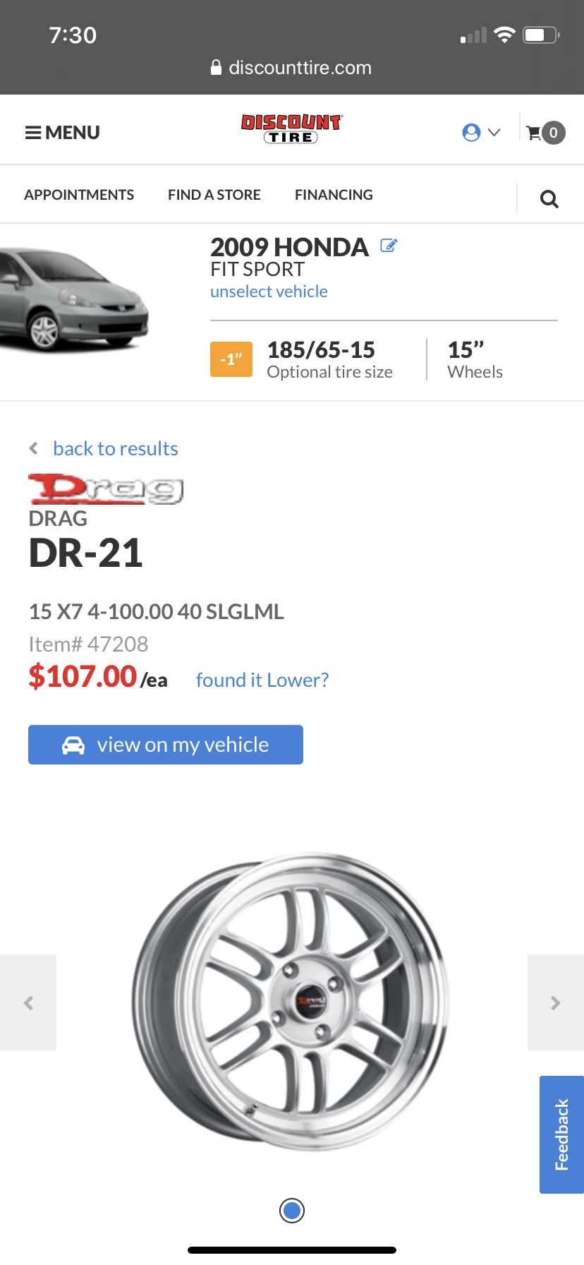

Did a little poking around want your opinion on something found these drags this is how they stack up.

Lower quality replica of an RPF1.
The big weight difference might be noticeable as far as fuel economy goes.
Personally I'd buy the RPF1 if those are your two favorites...but I would just never buy any replica wheels.

Gotta side with Mike on the name brands.
The question you're posed with is "where does the savings come from?"
Couple years back a proposition was made out in CA to repeal the gas tax, made national news, pretty bitchin. But would the state take a hit to save us money? The offer was to take the savings, lots of cash, out of freaking road maintenance. Now, if I had a fjcruiser, I might not care, but emergency medical services put out lots of funds to tell folks.. that they don't wanna ride in an ambulance over roads that are poorly maintained. they're often bad even when they're good.
Not always the case, but one way knock-offs save funds is reducing build quality. Could be the finish, the composition, labor, maybe they don't test their sh*t as thoroughly and it has heavy points that'd make em shakey at high speeds. It may only be one in a set of four that's botched. Finding where they cut said corners here would be tough, and returning them would cost a penny or two in labor and time. So I'd say to rely on a tested and proven wheel if you don't have funds to cover damages resulting from component failure.
RPF1s are a slick choice. You would feel the difference from the weight reduction. my ide set woulda been Volk CE28s, but that stuff aint exactly in budget. Not sure about now, but they were the superlative, lightest, and not a bad look.

I've owned real RPF1 and have compared to the Drag's. While not really apparent in the photos the spokes are shaped differently. Weight savings is in the rim area of the wheel. That's where it's most important. The lighter the wheel on the outside will provide quicker acceleration. Keep in mind with lighter weight comes more easily bendable from a pothole hit.
Most replica wheels are heavier than the originals. I believe the Enkei are flow formed?
The only example I'm aware where the replica are similar in looks and weight is 15" Desmond Regamaster EVO and Rota Slips. The bigger diameter Rota slips look different than the Regamaster. Looks are similar on the 15's and the weight is close. The Rota are cast weigh like 12# in 15" and the forged Regamaster from memory are like 9.6#. In percentage the weight is huge. Picking them up by hand they feel similar. I don't think on a street car one would notice the 2#?
