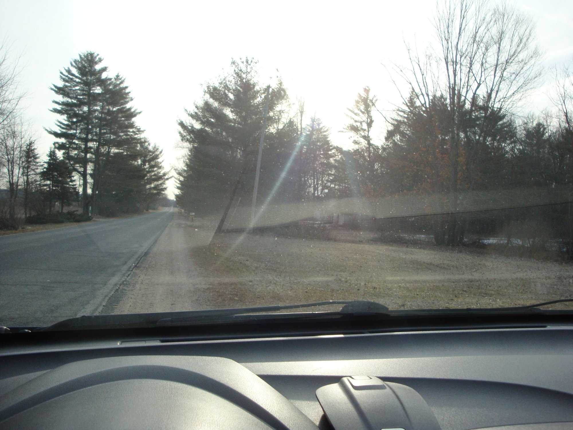

^^^ The angle doesn't matter. As long as the sun is shining in the windshield..it is there.
I took a pic this morning...it would have shown up better if it hadn't been a hazy/semi-cloudy morning. But, you can still see it. I laid my coat on the dash..didn't make any difference. If I lean as far to the right as I can...it's still there.

That looks like the windshield itself. It’s basically the sunlight bouncing off tiny imperfections, scratches, dirt, whatever. You can get the same effect with a smudged camera lens. (It’s partly why expensive/pro cameras use lens hoods.)

So, to be clear. In the picture of your windshield, there's the reflection of the dash that kind looks like \ and /. Then, to the right is a single water streak and a line that goes from the sun, cuts across the bottom end of the water mark into a "dark" portion of the reflection of the dash.
We're talking about that line?
You said that it was there even when you lean to the far right? Did it move across the windshield with the relative view of the sun? Or was it in the same spot on the windshield?
If you thought it was a reflection off the headlight, did you try covering the headlight (with your coat?) to see if the reflection was still there?
Another thing is, did you try wiping the inside and outside of the windshield? It could be lens flare off the windshield. If the wiper left even the lightest of streaks, those can dry up leaving "marks" that light was scatter about. Try wiping the outside across those possible streaks (instead of following their path). Maybe its time for new wiper blades?
If its lens flare, there isn't much you can do about it, other than hoping that you can wipe the windshield and leave even less traces. I don't know if waxing (polishing?) the windshield would help or make it worse. The only other solution is to avoid driving without having the sun shine at you from the front... though, that could make your travel time way too long. So, if its not blinding you, its easier just to ignore it and proceed with your drive normally.

The headlights were off in the pic and anytime I've seen it, it is in the daytime (morning..when the sun is in the forefront). It can't be the camera, because I see the same thing before taking the picture.
Talking about the diagonal white line...the others are windshield smudges or camera lens smudges. It always looks like a drooping cable from the sun to the junction of the a-pillar and hood.
Wiper blades are new. I always spend extra time cleaning the inside windshield with mr. eraser cleaner pads and invisi-shield. I am pos sure it's not a cleaning factor.
When leaning across...everything else that reflects moves, but the 'cable' stays close to the same point on the windshield.

Even if your wipers are new, it doesn't change the fact that the windshield itself isn't. By that, I mean, over time it can wear down the surface with micro scratches. Wipers will do that, especially when they're dry. In a light drizzle, parts of the wiper might get wet, while other parts stay dry as it goes across the windshield. Add a little bit of dust and dirt, and its basically super soft sand paper. Now, multiply that one time across the life of the car and things like this will happen.
And I wasn't meaning a reflection of the light of the headlight, but a reflection of sunlight off the headlight housing. Otherwise, we'd be talking about how it affects your nighttime view, not early morning, into the sun view.
PS. your windshield is basically the same as a giant lens, even if it doesn't magnify your view. So long as light is going through it and anything like imperfections like punx45 said, it can still produce "lens flare." That's why neither of us said it was an issue with the camera.

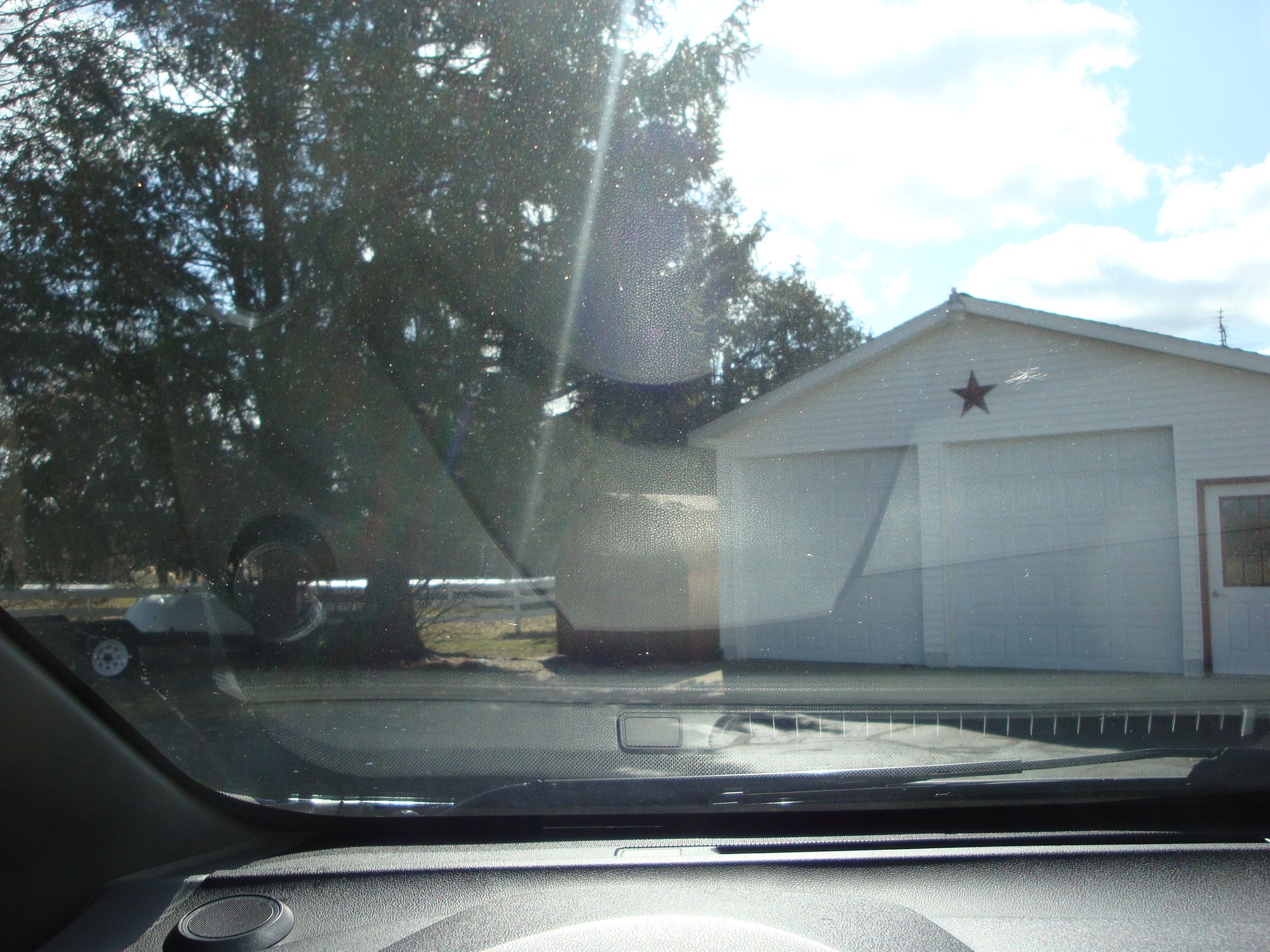

One more thing... in the pic above, the diag white line is what I am talking about. All the other faint lines and bars are just reflections from the interior of the car.
The sun was just over the tree line, at the end of the white line..but the camera couldn't show that because of the brightness.

The sun came out good around noon today. That's why this pic shows the bright line nearly straight up, instead of drooping. I got in the passenger side and it was the same.
But...when I moved my face as high and right and close to the windshield as I could...I could see that the unwiped portion didn't have the bright line. Not much of the windshield is untouched by the wiper coverage.
Are there any options other than windshield replacement? I'll just live with it if so.
The dash is also reflected in the pic...otherwise it would be much clearer.

As for dealing with the wiper marks... well, sure you could replace the windshield, but the issue would just come back again sooner or later.
You best bet is to try to find something, like wax or some coating that would fill the gap, possibly harden it so it takes longer to happen again. I wonder if that whole "self-healing" ceramic coat would work?
It might also be necessary to polish the windshield smooth first, then coat it. As some coatings don't fix old issue, but only prevent new ones... or something like that.
