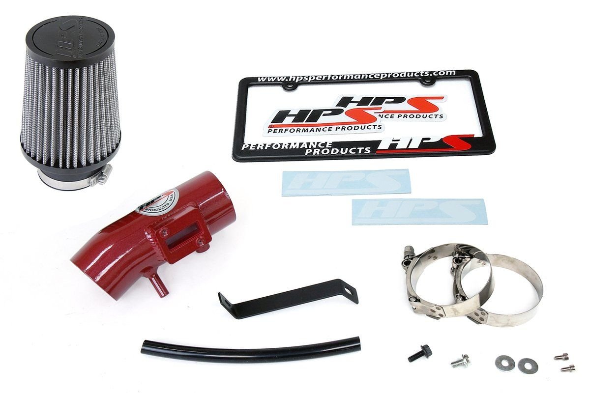

Bought a 2nd hand hps intake off of @baggedfitty waiting for it to get here and have been looking/ reading everything I can but I have no clue how to “hose” this shit up I see 2 hoses on stock and 1 on the aftermarket anyone got pictures/diagrams or info please drop them below.
ANYTHING will help thx.
Also to those “google it” boys google only brings me to pages of people arguing about it working or not working tbh idc I’m doing it for sound, look a reuseable filter and mpg not to make my fit have 200hp so please don’t bring that here.

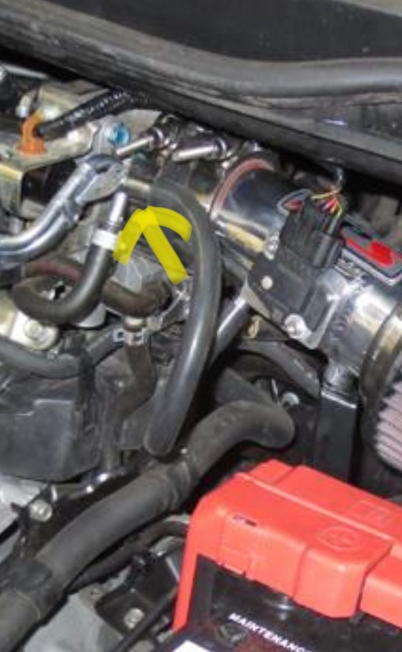

Remove the 2 OEM hoses, air box and air sensor. Instal air sensor in new hose. Hose clamp it to the throttle body. Hose clamp the filter on the other end.

This picture helped me a lot hopefully it helps someone else with their install.
