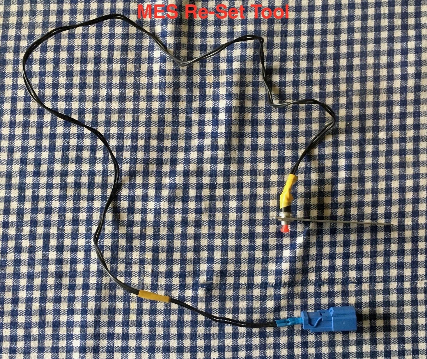

So I have a device that I made that plugs into MES for work on a CRV -- much nicer than using a paper clip to jump MES terminals BUT I can not find the MES connector on the '09 Fit.

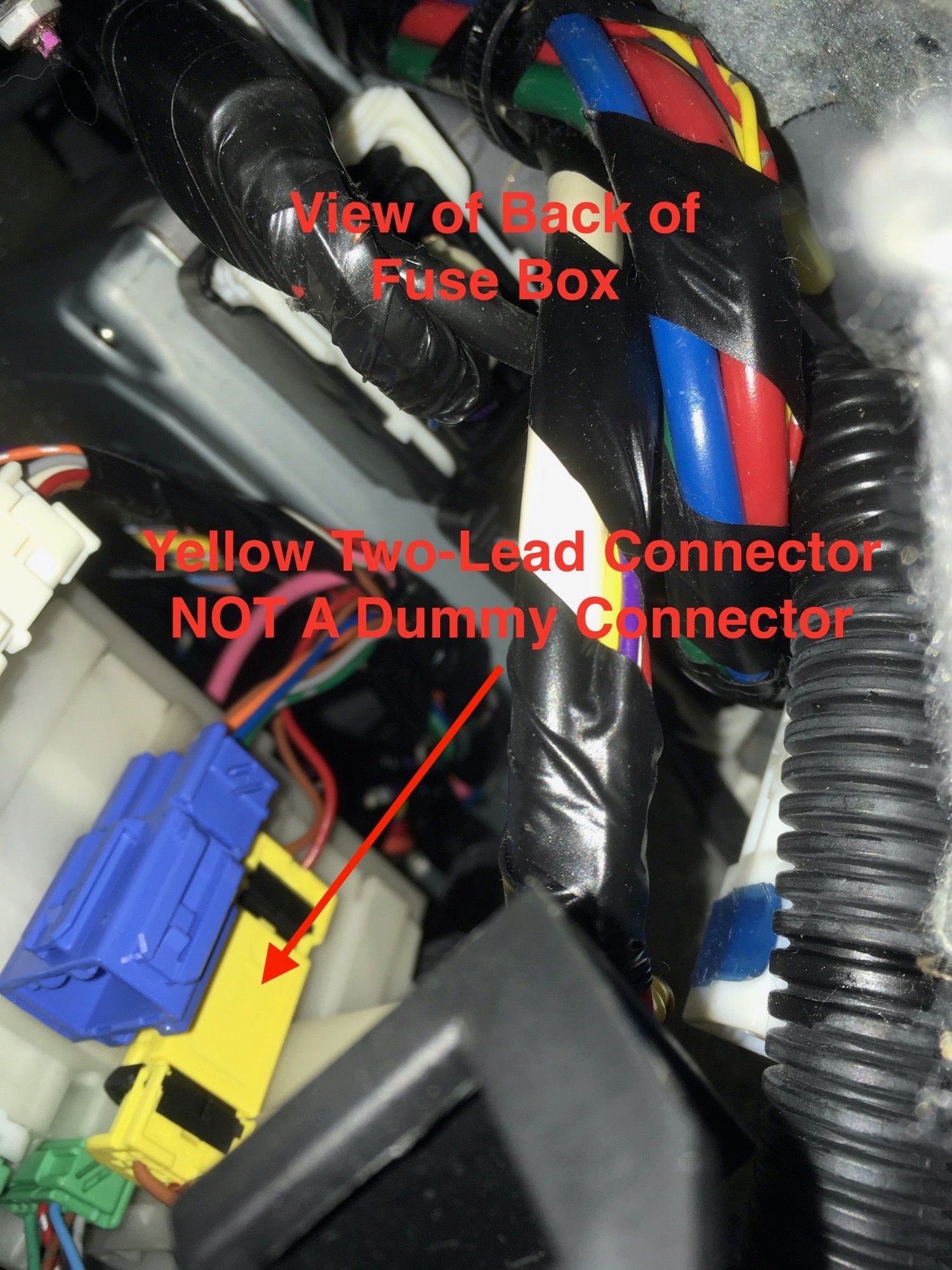

At first I thought that this connector was attached to the bottom of interior fuse box (because this connector two leads, is yellow and leads are wrapped in yellow tape) but I see that this is not a dummy connector so I do not think that this is the MES connector that you use to reset srs light.

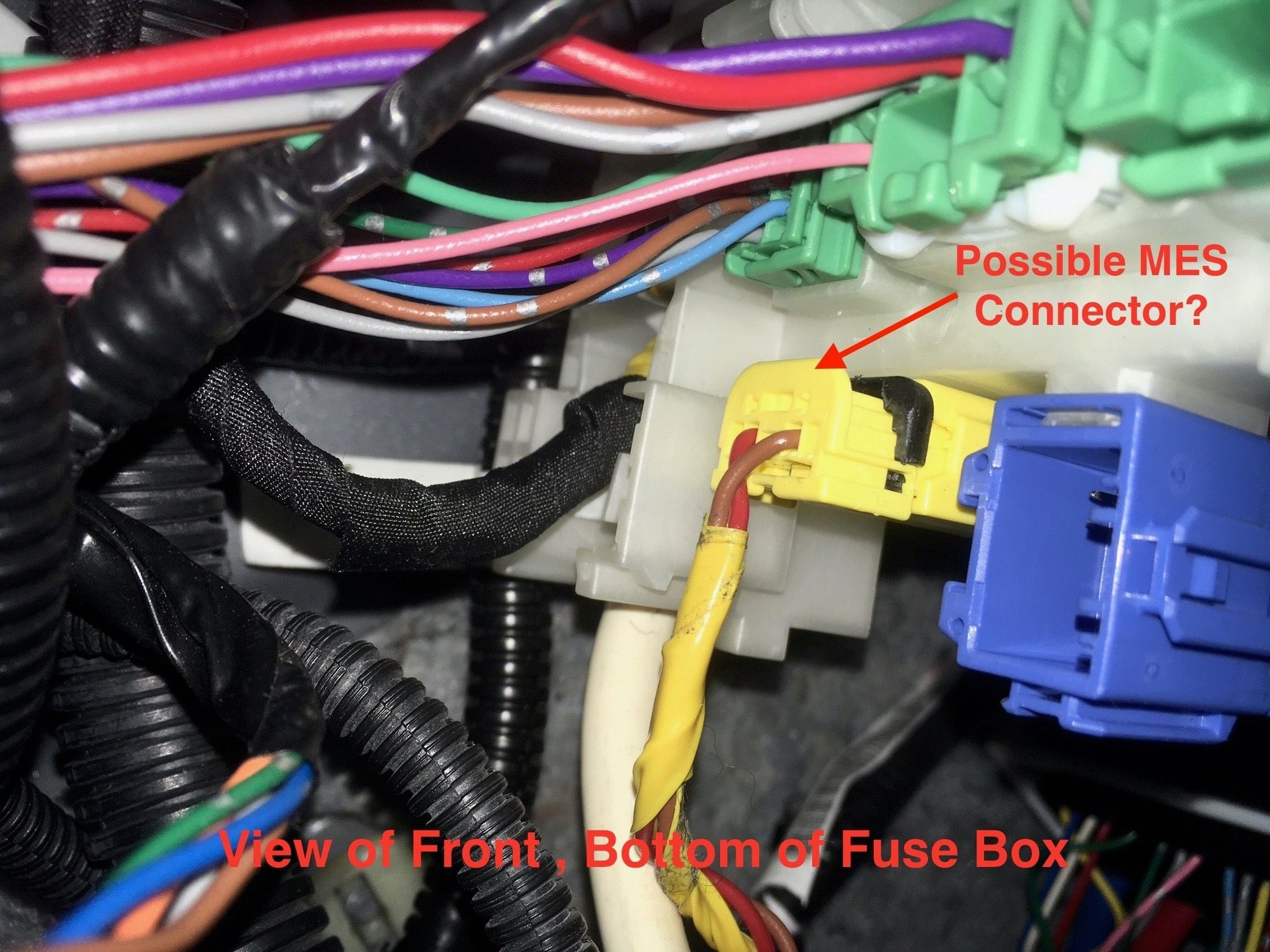

I'll post of photo tomorrow a.m. of fuse box to show the connector which I think is incorrect one.
Perhaps the MES connector is wrapped up with tape attached to some looming above kick panel / under or near steering column?

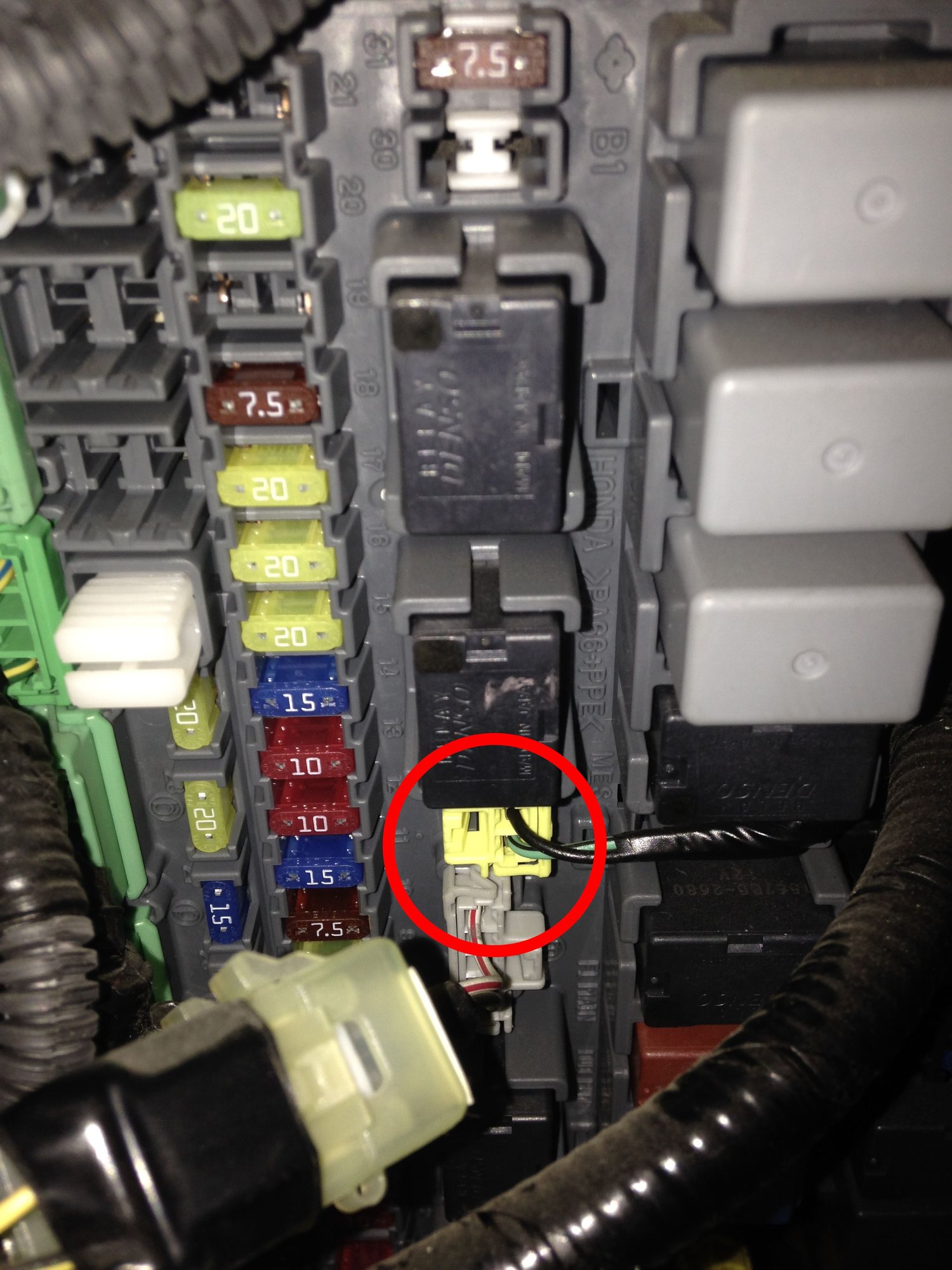

Well I found two possibilities. One is on the fuse box itself, but the picture referenced is from an '08, no idea if it's similar for the '09, haven't looked at my fuse box in a while.

The in cabin fuse box on an 09 is different than on the 08 (I'll post photo later) and as of now I see no yellow connector plugged into the box itself. I do see a yellow two-lead connector attached to the bottom of the box, but that connector is plugged into another connector which has wires emanating from it so it seems that it this is NOT the MES connector because, as I understand it and based upon my experience with MES connector on CR-V, the MES connector is either just loose with no connection to another connector OR plugged into a fuse box with an empty cell. Before I open up that yellow connector attached to back of fuse box (very, very difficult to access, btw), I'll look around wire harmesses below steering column to see if I can find connector taped to harness. Photos to follow later.
