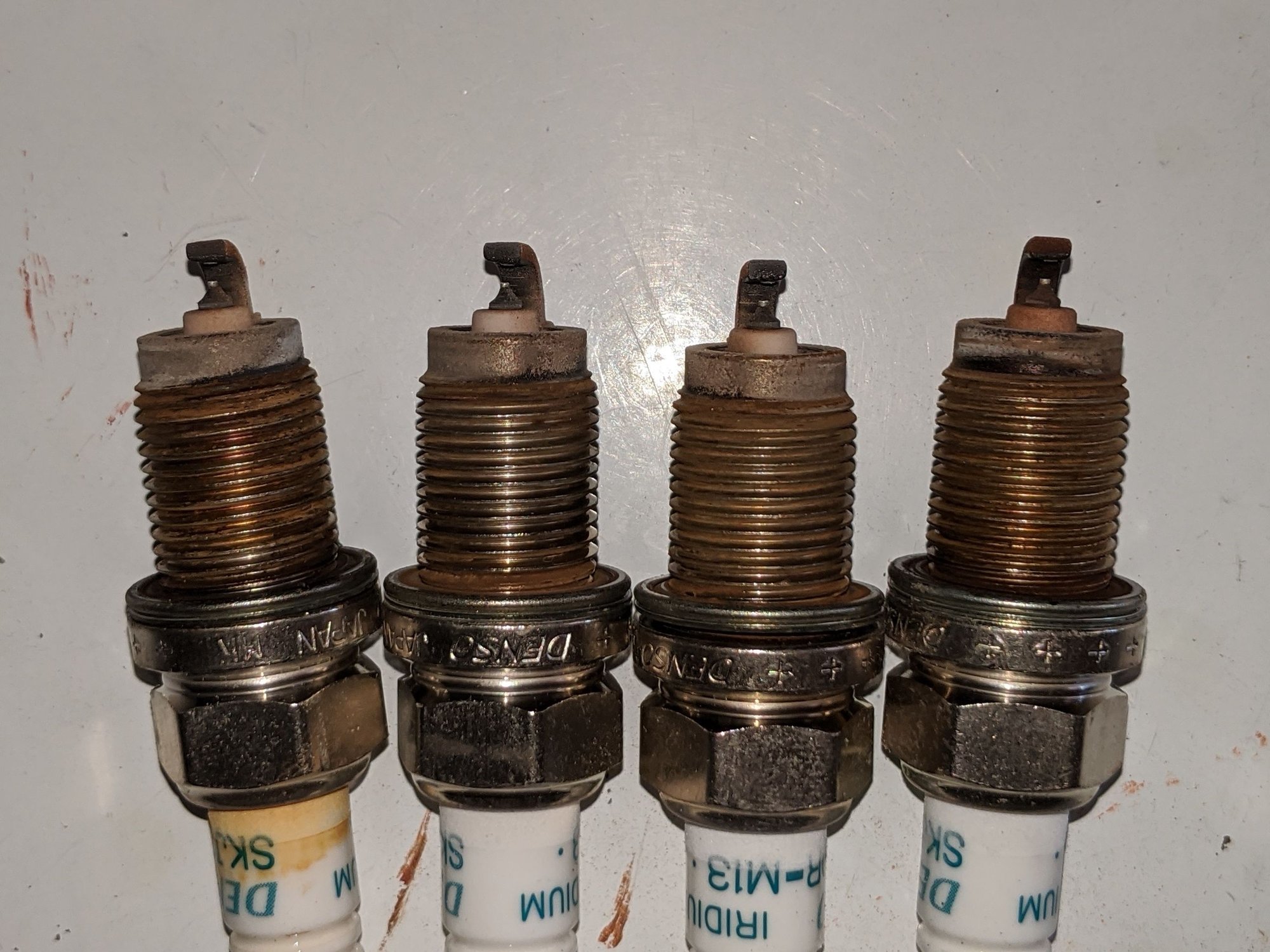

Atleast now I know now the valves and plugs had a 100k mi service. This is what came out of the car and the new ones I put in. Plug no1 seemed a little bit looser than snug. Plugs 234 were just snug.

Nice! Good to have that behind you for another 90k miles or so. I should have mentioned to definitely have your battery disconnected during the adjustment. Maybe it's my imagination, but it seems our car picks up a fair bit of power after the adjustment, but I think that it's necessary for the ECU to relearn air flow after the adjustment.
Bent feeler gauges are pretty much mandatory. Or, doing what you did and bend a set.
Key for no leaks is to remove that old dab of gray sealant and apply new sealant. I've been using the same tube since 2010.
Happy motoring! Your next adjustment will take a fraction of the time.
