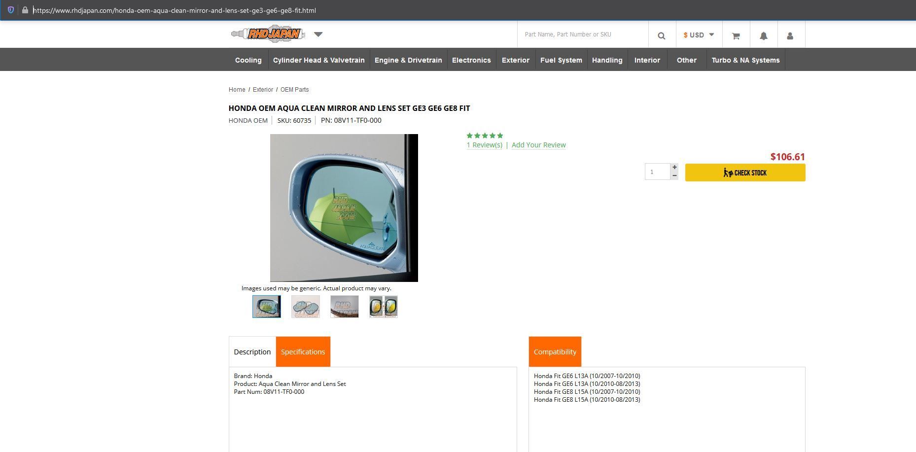

just go in and try these out and report back!
https://www.rhdjapan.com/honda-oem-a...6-ge8-fit.html

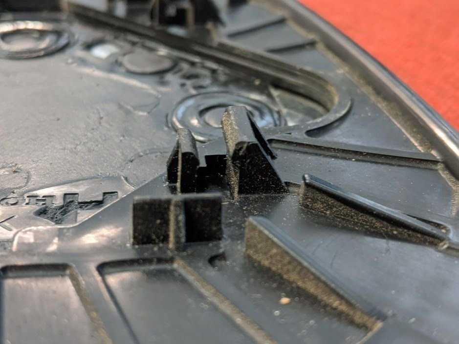

Here's the back of OEM driver side mirror, and it's the same thing on the passenger side. Basically the same with the aliexpress cheap-os.
I don't know the technical term for these things, so this is my best description.
The green arrows are these plastic hooks at the top of the mirror and hook into another plastic piece inside the mirror housing.
The red arrows are clips that a piece of plastic in the housing pops into.
The blue circle is adhesive backing similar to 3M tape. It's that whole area that is exposed. Only the driver side really stuck to anything in there, so it was slightly more difficult to pop out than the passenger side.
I'm sure you could be more delicate with some sort of trim tool, but I slid my hand behind the mirror from the bottom of the mirror and just pulled the mirror out from the bottom and then slid the top hooks down and out. Just a good pull popped them both out. Maybe a little harder than you're comfortable doing to a piece of glass on your car, but you just need to get those bottom two clips out.
This is one of the red arrow clips.
This is one of the green arrow hooks.
