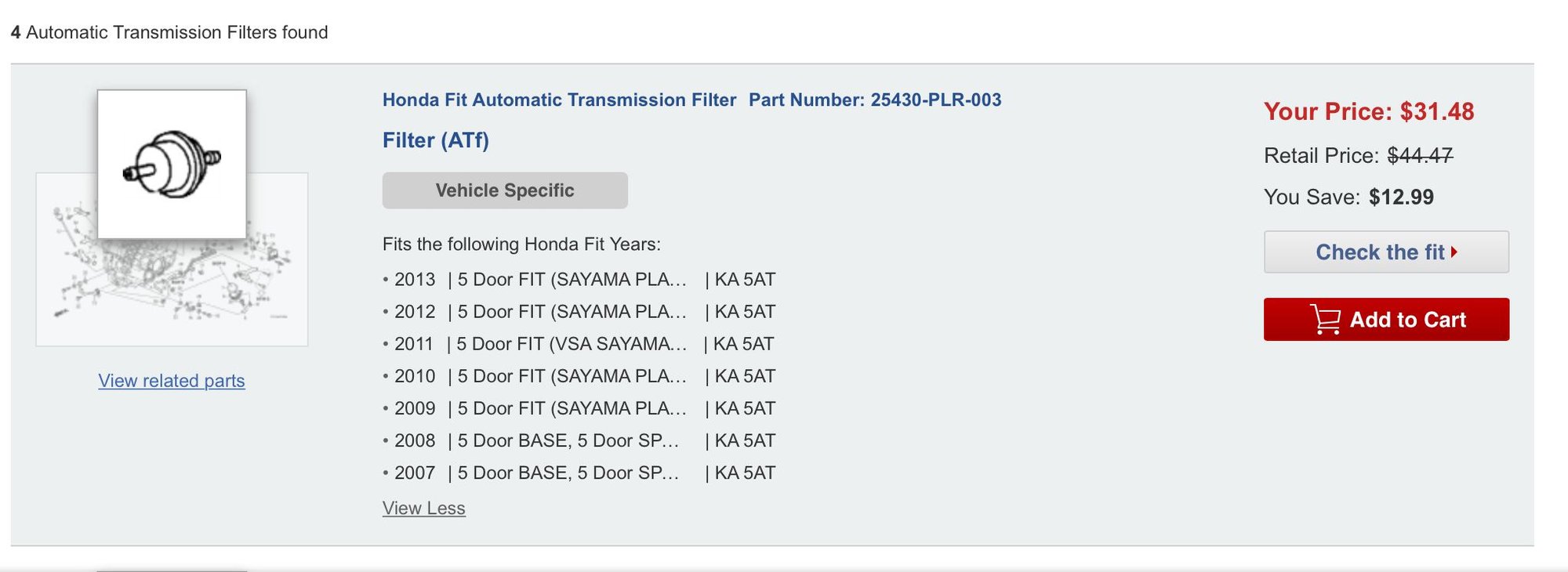

I just bought a 2013 fit base from the Honda Dealer in my town with 97,000 on it.
I got them to change the transmission oil before I bought the car.
After reading about the trans oil filter I checked to see if they had also replaced it,
After finding they had not changed the filter, I called the dealer and asked if the trans filter change is part of the transmission service package on a fit.
The person in service told me the Fit has no transmission filter and went on to say no Honda cars have transmission filters.
I told him I think the Fit does have a trans filter he again said no way Hondas have Transmission Filters.

Also, if someone has any Honda Doc that proves the 2013 Honda Fit, auto transmission, does have a transmission filter please post the doc.

Answer to points 1-5 , yes. Filter is located under the air filter box.

Manuals have a filter internally that is meant to last the life of the car, but the autos have serviceable filters, as fit09 has already mentioned.
