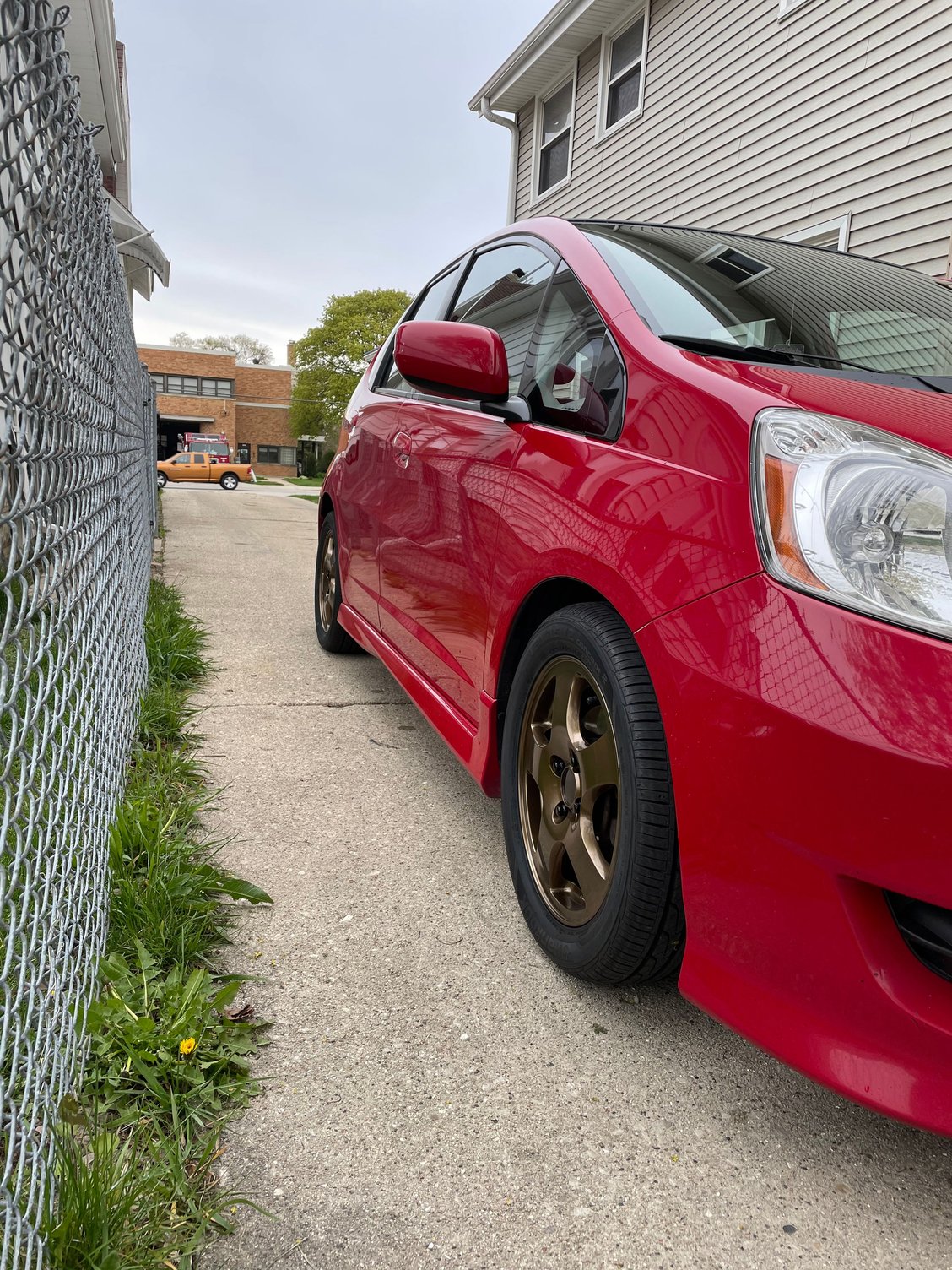

Update. I installed the bilstein coil overs a month ago but finally lowered it and put on my summer wheels today. I scored a set of Gsr fat fives for real cheap and got them powder coated bronze chrome. Also installed an alpine CarPlay head unit and made a shift knob out of an old pair of bmx handle bars. I’ll take some real photos soon. Bonus shot of my roommates Datsun 510.
