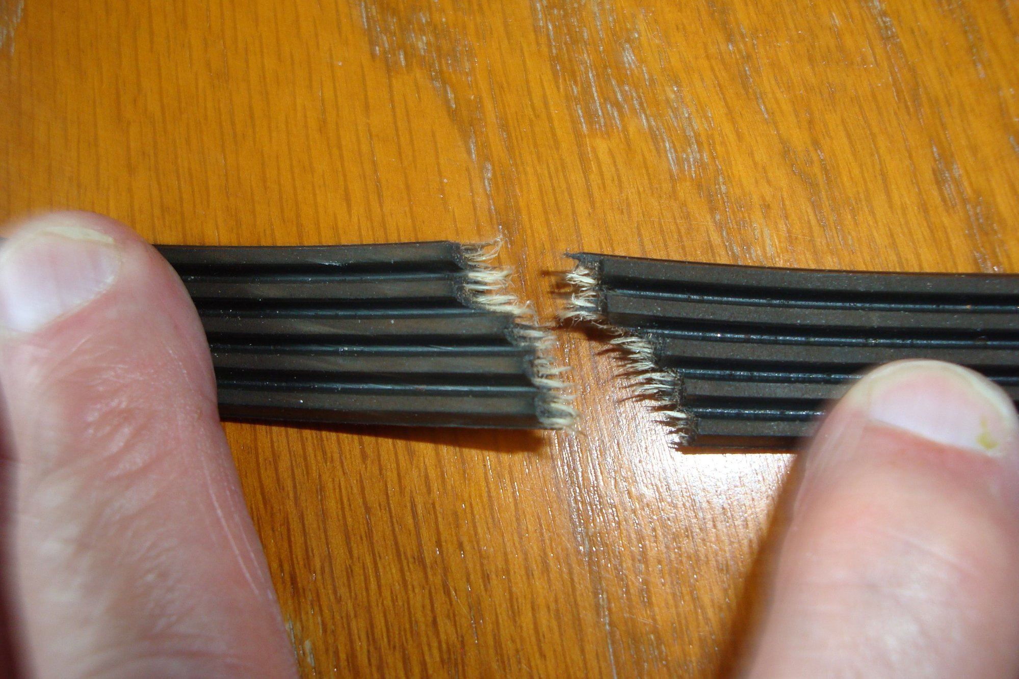

Starting the Fit this morning...as soon as it fired up, I hear a 'snap'
Battery light on...can mean only one thing....serpentine belt kaput.
Didn't have a 'serpentine belt tool'...so I had to rig a substitute. I was doing the job by myself..so I didn't have any extra hands.
I ended up using a box end wrench with a 7" piece of wood to pry the tensioner back while I threaded the belt on.
Had it most of way there but needed to turn the engine to get it seated all the way over.....which went easy with a socket on the flywheel and a long extension to a breaker bar.
There isn't much working room on that end of the Fit engine.
I have 235K miles on the car....not bad for the original belt.
Will be the last one for this car.
Anyone else have the belt give out when starting?
