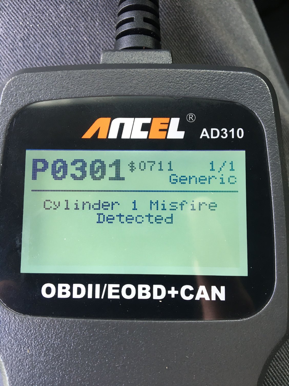

Welp, my wife called and said on the way to work the check engine light and the traction control light came on. Not sure what the relationship with the traction control light is, but I'm assuming the ECM finally recognized the misfire. I'll run the codes once she gets home and see what it spits out, but I'd be willing to bet that it will be a misfire code...
I've got some laser iridium spark plugs and ignition coils in my Rock Auto shopping cart. If it spits out a misfire code, I'll go ahead and replace all 4 while I'm at it.
I'll keep yal posted...!!!

Old Jul 26, 2021 | 02:03 PM
vtchopperdude's Avatar
Joined: Oct 2020
Posts: 49
From: Valdosta
New iridium spark plugs and ignition coils fixed the problem.
