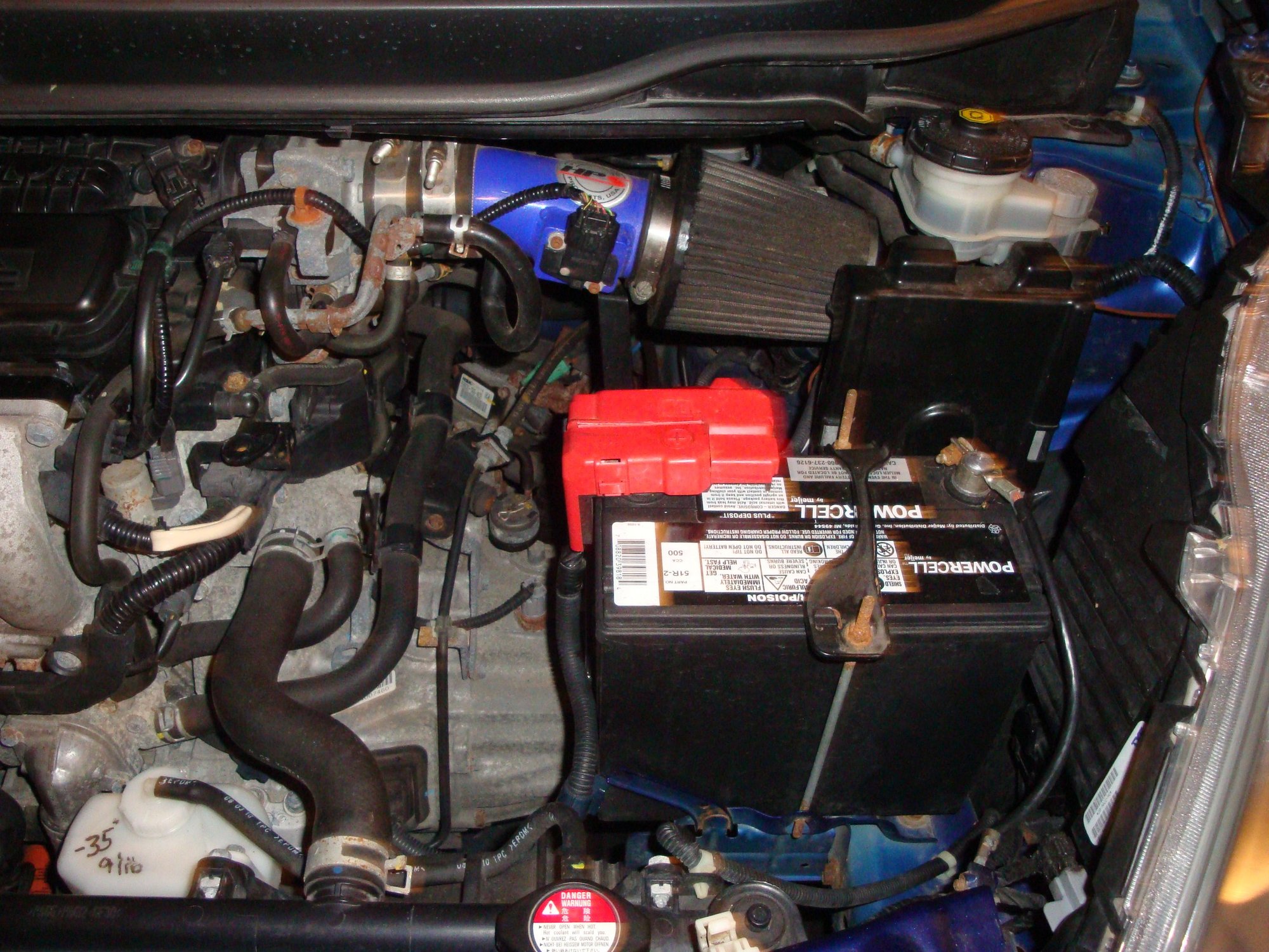

@steve37 @NWCH Nice pics! That Top Fuel intake looks particularly slick. I'm no air wizard (that was my father's bag, but I didn't learn enough) but I wonder if they were trying to increase air velocity with the duct shape. Seeing the outside diameter of the carbon fiber section inclines me to worry
But it looks like you know what you're doing, and I'm pretty sure I've seen you around here for a while.I'm glad to hear the HKS works too! Since (I think) they're similar in design, I'd like to see a side by side comparison of the HKS and K&N.
OP's got some options if buying a new intake is on the table!
Ya the Top Fuel piece is quite the setup. Unique for sure.
A big improvement over stock using the old butt dyno. Sounds good also.
I looked it up!! Can't afford, but would actually try that one. When talking intakes I largely withhold interest til I hear talk of how the air moves through the ducting. I couldn't find anywhere to buy that intake through. Import sites with huge shipping rates and pictures slightly different from yours with regard to piping.
