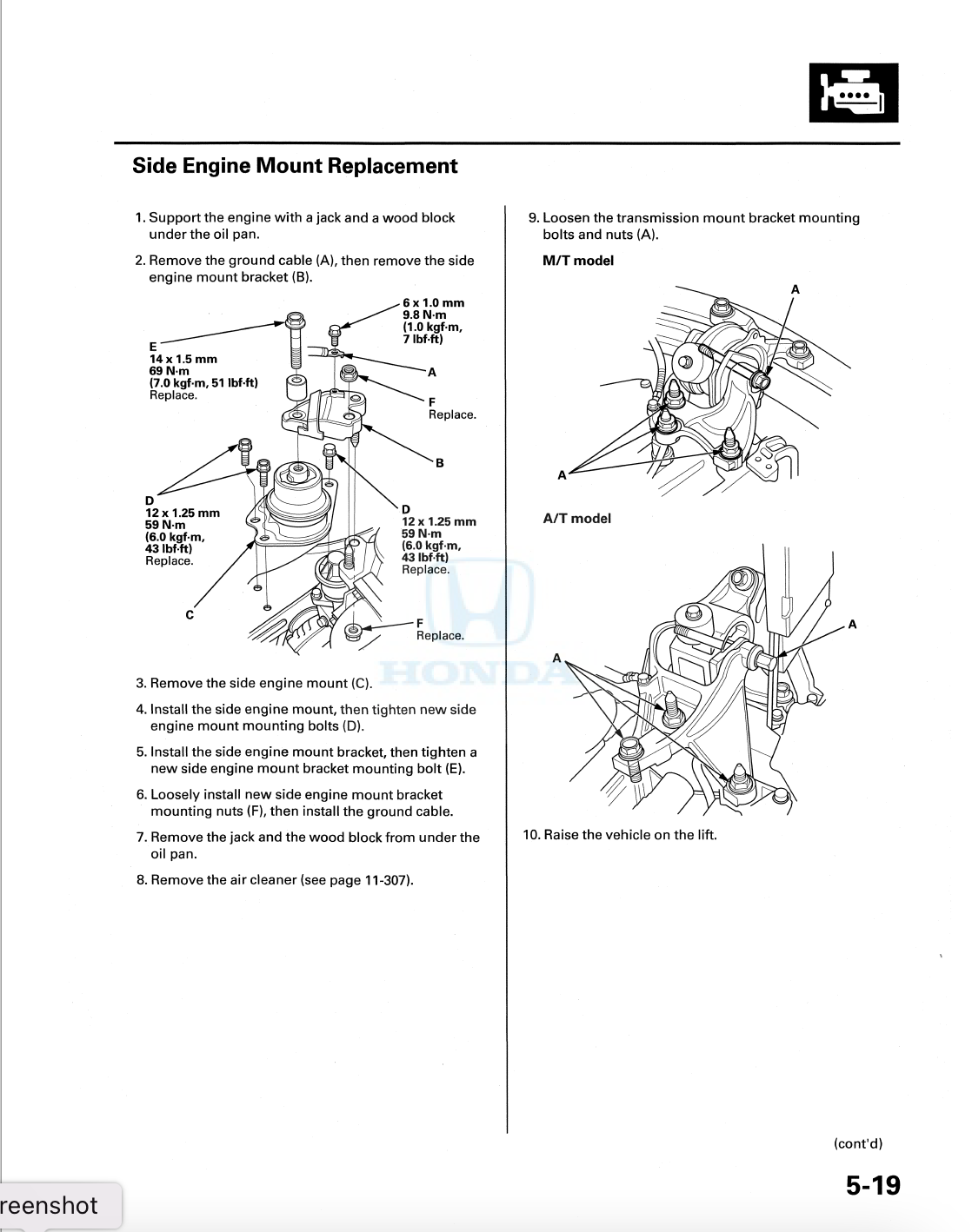

My monthly project for my Fit (I like to doodle) is to replace the passenger side engine mount. It looks like I can jack up the engine, remove the three bolts holding the mount to the structure and the large bolt in the center. Then pull it out. Is that the procedure? Do I remove the rest of the mount that's attached to the block?

Service Manual 5-22

Many thanks! Guess I do have to take the bracket off as well. Think I'm going to order the bolts/nuts.
