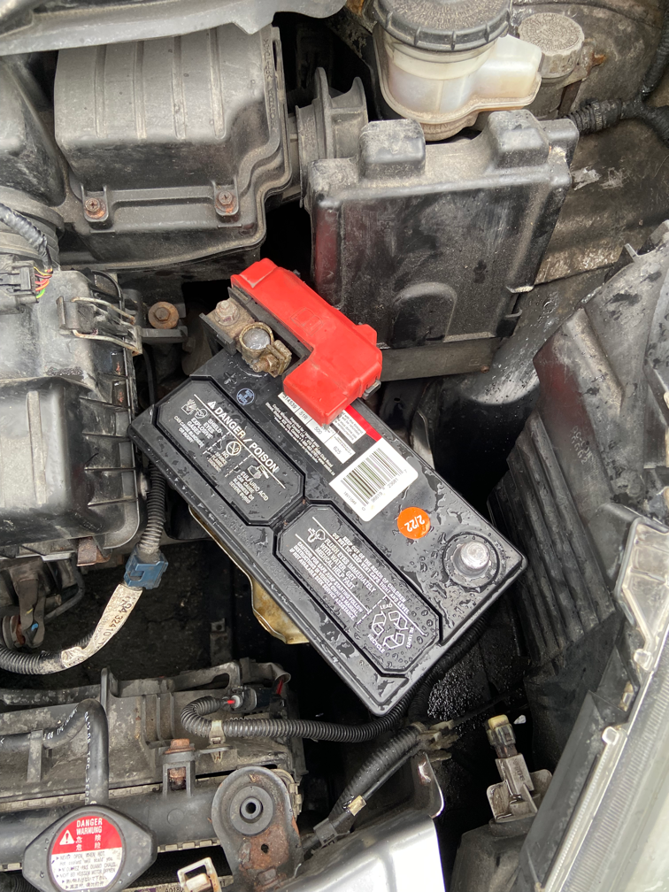

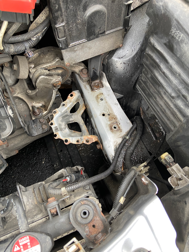

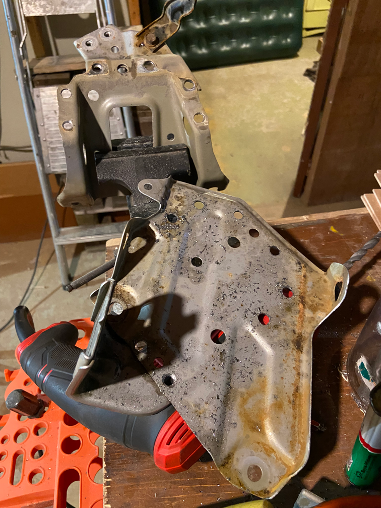

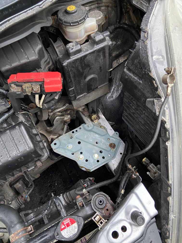

Hello,
My 151R OEM died after two years so I went with a 51R from Costco but had to install it a bit sideways. To do so I went to the scrap yard and bought a Fit and a Civic battery tray to Frankenstein them together. I got both to keep my original in perfect condition just in case I want to go back.
Drill up the solders on the Fit tray
Drill up the solders on the Civic tray
Separate them
Remove the 12mm fasterners in the Fit (2 on top, 2 on the side with extensions)
Test fit the Fit sub tray
Test fit the Civic tray
Bolt it together
Install the cut down Civic plastic tray
Installer the 51R battery sideways
