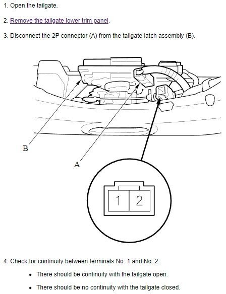

Honda Fit Sport 2013. Was hit in the rear and somehow distorted the hatchback. Waiting for insurance to do their thing. Car is drivable. My problem is now the door open light on dash is on due to the hatch not closing properly and it prevent me from setting the alarm. As a temporary fix, I like to bypass the door switch.
Anyone can help by telling me where is the hatch door switch located, so I can bypass it?

Take the plastic panel off the hatch. Unplug the 2 wire connector

Thanks a lot. I will try that this morning.
