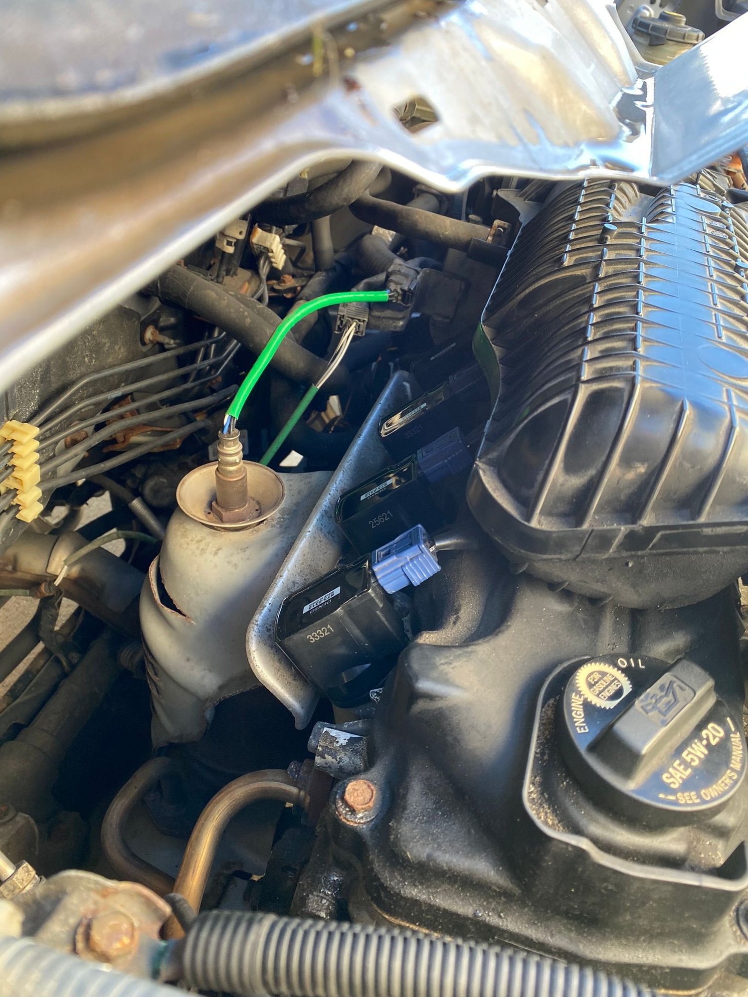

Hey All, I rarely have posted much on here since I took delivery of my 09 Fit back in October 2008, but I wanted to share something that was concerning me about my trusty ole Fit. With 214,000 miles, I started to experience what I thought was an automatic transmission shudder while driving. I was in denial a bit because I change the transmission oil with Honda oem synthetic very 30,000 miles and even have replaced the “fun” to get to external factory transmission oil filter at 150,000 miles….that was a story in of itself as a dealership kept telling me that my Fit did not have a transmission oil filter when I tried to purchase it from them. Oh well I did take care of it when I found the OEM part on line and ordered it. Back to the present issue, it seemed to happen after 20-30 minutes of driving for the past month or so…the car would just shudder quick while accelerating. Since I have always done all the service and repairs on my Fit except for the recall fixes for air bags and front transaxle shafts replaced, I started to research “transmission shudder”. After a few days of on line research, I started to think/hope my issue was something else. It was another fit owner describing a similar symptom plus noticing the smell of gas!! occasionally.

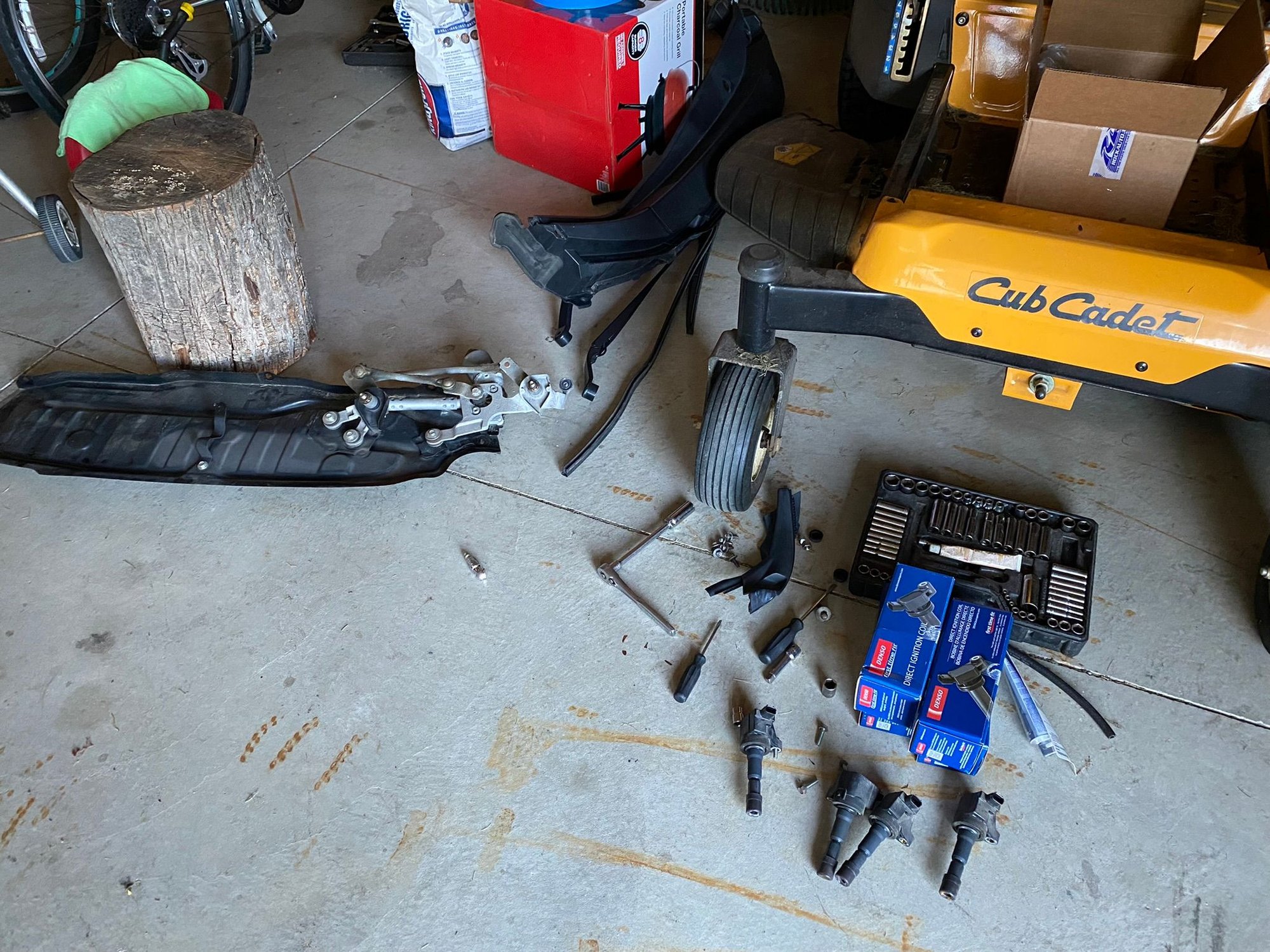

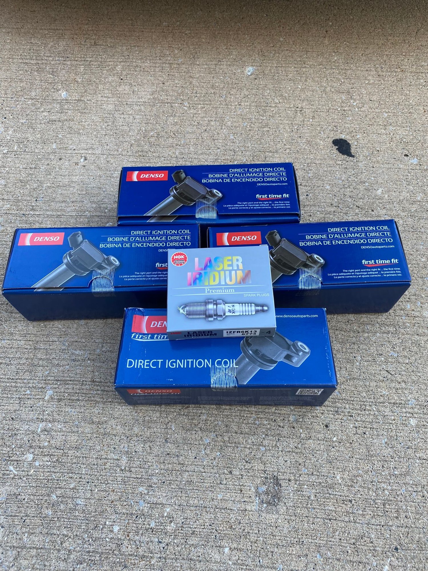

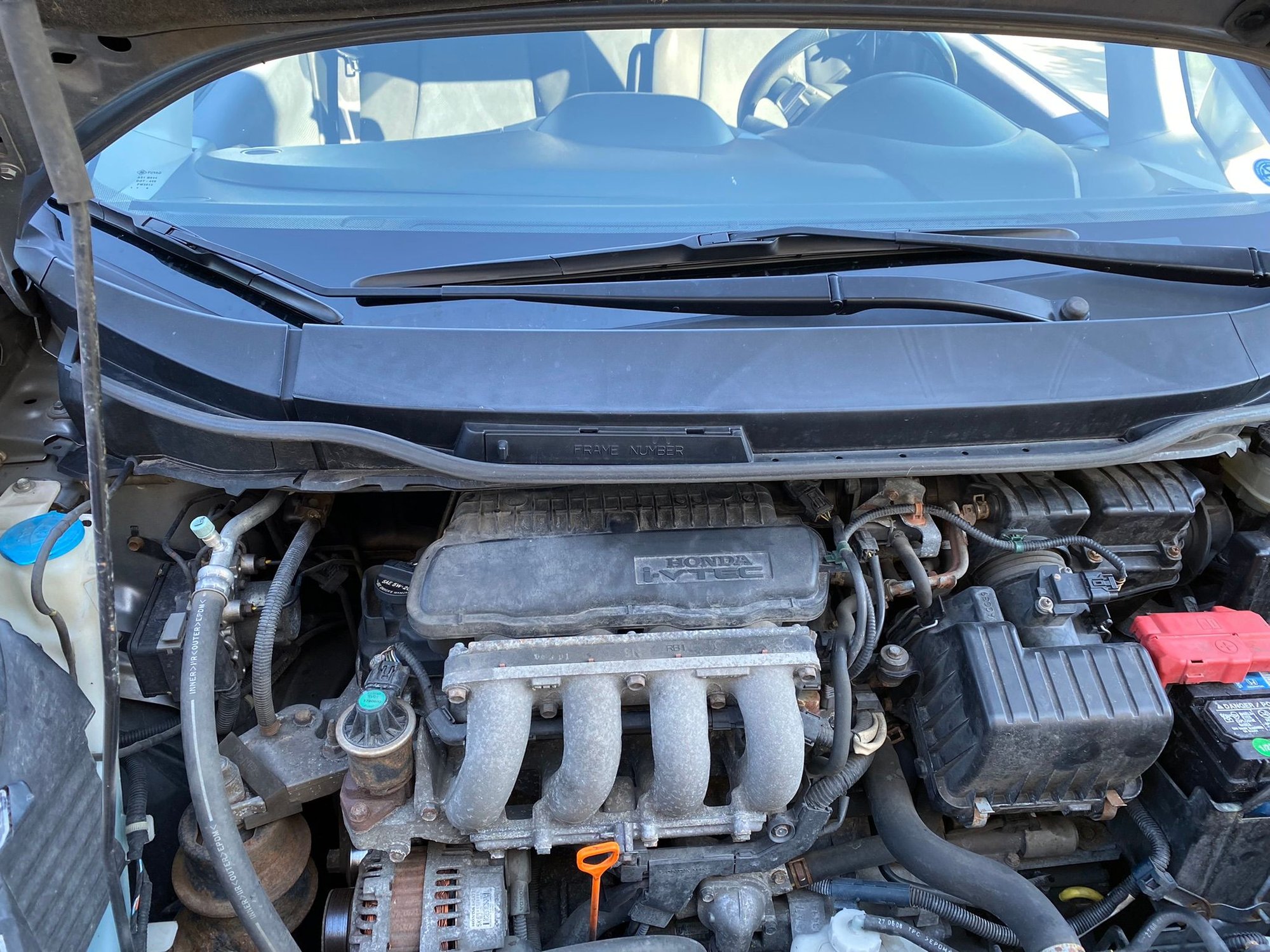

This being a possible sign of a misfire due to spark plugs or more likely coils needing to be changed out. I did replace plugs at around 130,000 miles but my Fit still has the factory coil packs. Long story short, I ordered the following shown in the photo and dug in this past Saturday am replacing. I have become pretty good at removing the wipers and under hood cowl section over the years for various reasons. I just wanted to share that this job is not bad at all and omg what a difference it has made for my Fit. Not only is the misfire gone, but my car has noticeably better acceleration and seems to idle smoother with app 100 higher rpm.
I love this car and glad to have resolved the issue with some new parts and my elbow grease. I used NGK iridium plugs before with good results and went with them again along with denso coil packs based on online suggestions. The factory ones I removed were Hitachi brand btw.
