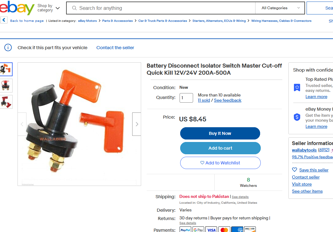

NO. dont get bigger battery. I have been starting my k24Turbo Fit with just 18Ah battery even after 4-5 days it cranks right up.
just do through leak down test. and if no cause found you can buy this cut off switch and just turn it off when parking car for long times.

So, wire the switch into the ground battery terminal? difficult to see in your photo

i have wired it into my +ve.

Yeah but if you use a kill switch to solve this problem, you'll lose the radio and any preselected stations. I wouldn't want to put up with the hassle of having to enter the code everytime I started the car. Plus having to reprogram the stations. I'd try to figure out what's causing the parasitic drain and solve the actual problem. It has to be something that's protected by a fuse so you should be able to find the problem with a multimeter. Yeah, it's a tediuos process but I don't know of any other way.

yes you are 100% right. This method is just a backup method. and not suited for a normal car. since mine is heavily modiefied from engine to radio. so it does not affect me atall. but saves me of hassle of battery drain since some time i use car after a month or may be two months apart.
