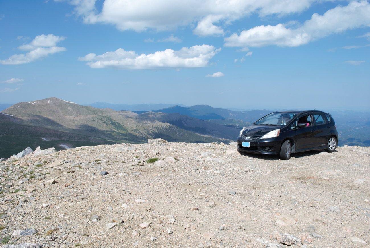

The alternative for me is buying a new Ford Bronco base or Maverick XLT, both of which would cost me about the same. Avoiding having a car payment is the goal since I have never had one before - though I will be making pretty decent money at my new job. Attached is a pic of the fit on our last adventure to Colorado
