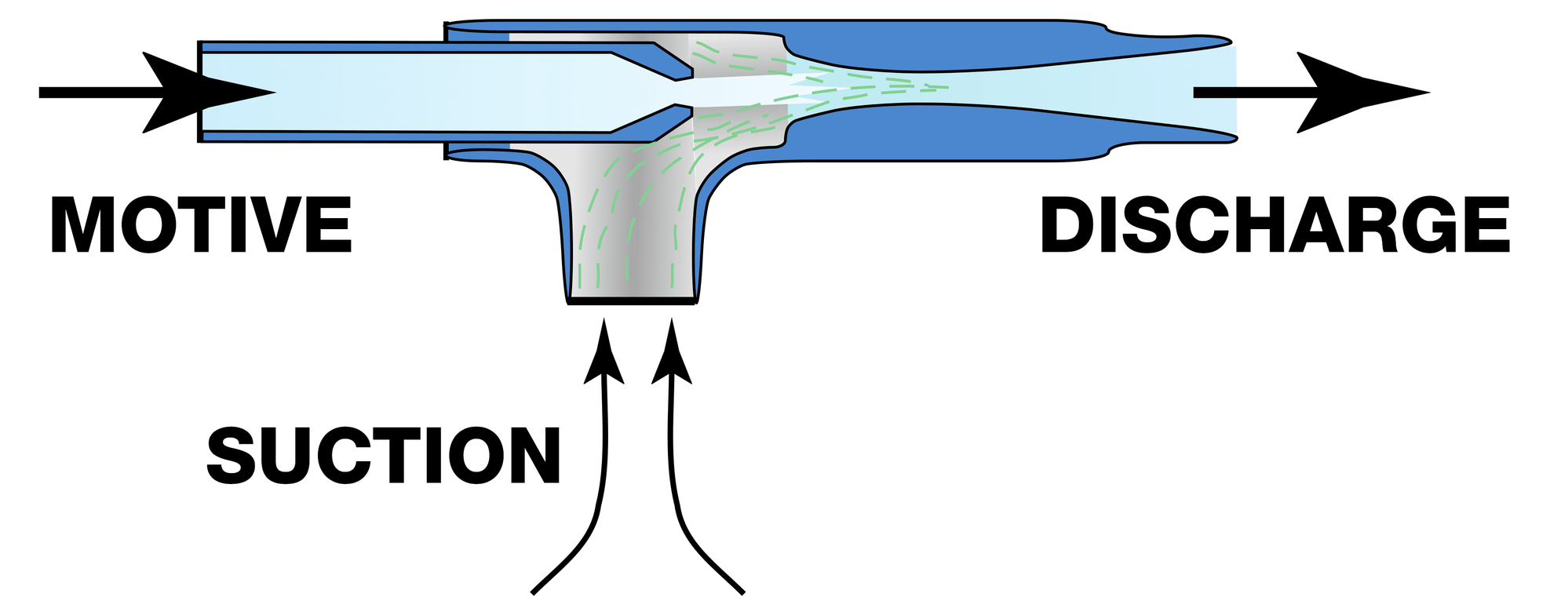

The PCV device is a negative crankcase pressure valve set-up that uses (don't quote me) a venturi, reed valves, and a tiny air filter stolen off a gas powered rc car. called a "T-REV". I have an ebay knock-off that I've been running for maaybe 5 years. link to vivid racing
I'll pull some date for you, then see if I can get around to setting it back to stock. pull numbers again. aside from what they mention (and disregarding their remarks about its having a precision tune in any way,) it also does a very good job keeping oil/blow-by gas out of my throttle body. i like it quite a bit, but can't perfectly explain it . link to where i got mine
design isnt far off from this google image result of a venturi
Import tuner led me to j's racing, which led me to the thingamajig.
