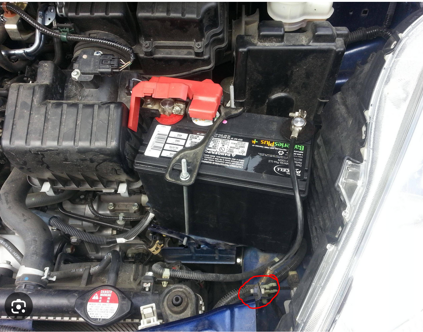

Do you have a photo of the wire your tightened?
I think he meant this bolt:
