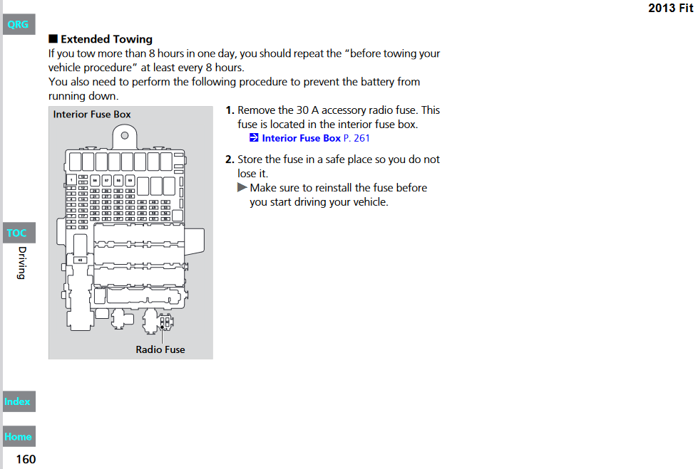

Going to purchase a 2013 Honda Fit today we found setup and with super low Kms (strange but its awesome) its an automatic and are wondering what the procedure is to place the car in neutral tow?
any quirks to worry about this?

As is usually the case, the owner's manual is your friend.
