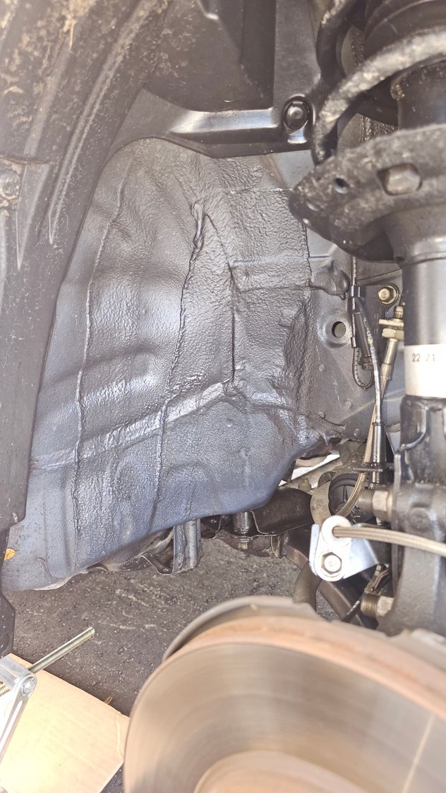

I put a set of braided S.S. front brake lines on my '09 Fit 4-5 years ago. Yesterday I made a really hard stop, and suddenly the pedal goes to the floor. Oh ----, not good...fortunately I didn't hit anything, and it happened close to home. Upon inspection the right front braided line had burst and sprayed brake fluid everywhere. I'm having both of them replaced at my local shop with OEM rubber flex hoses. Total about $290 parts and labor with tire rotation and adjust rear brakes
Frayed braided line burst
EBC pads and rotors in good shape
Burst line sprayed brake fluid inside wheel well

Had them failed on my 05 Accord also. Mine failed in the fitting where it is connected to the brake caliper. The fitting rusted enough so fluid could go out.
Never again for me. I'll stay with OE or similar rubber hoses.

Mine lasted about 4 yrs. It failed where it bolts to the bracket. It moved and the braiding got frayed. I was lucky it didn't cause an accident. Getting standard hoses put on this morning.

These were Goodrich brand lines, not some Chinese knockoff trash. I wouldn't trust one of the most critical systems on my car to that kind of item. From the appearance of the damaged hose, it flexed in it's mounting bracket from steering and chafed and cut the soft inner Teflon hose lining. It then ruptured under heavy braking pressure. Teflon will soften at high temperatures. The SS braid is simply there to keep it from expanding under pressure.
